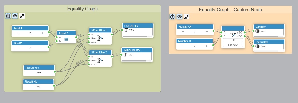

Situation: Learning how to use EKL in context of xGenerative Design custom nodes.
Target: Compare two inputs and determine their equality condition.
Proposal: please reference attached 3DXML, no geometry.
  1. Utilize the operators provided by xGenerative Design to compares two inputs.  In this case, from the category of the Operators Library I used the Equal (=) and If Then Else operators.
  2. Create a custom node in xGenerative Design to compare two inputs by using the Script operator from the category of the Operator Library.
> Functionality: The equality graph and/or custom node takes two inputs and compares the first with the second .  There are two outputs for this graph and/or custom node.  The first returns a Boolean value of YES or True if the inputs were equal to one another.  The second output returns a Boolean value of NO or False if not equal.
To the Community...
  • How could I improve the Equality graph using standard operators?
  • How might my Equality graph with custom node be improved?  Is the EKL script optimal or could it be written better?
Thank you.
