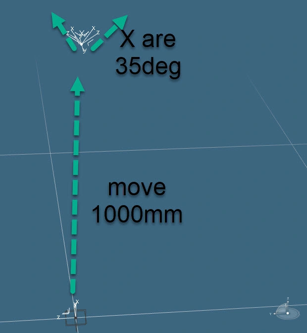

Here is the logic, the logic is still to drive a axis system which represents "the turtle" of the model

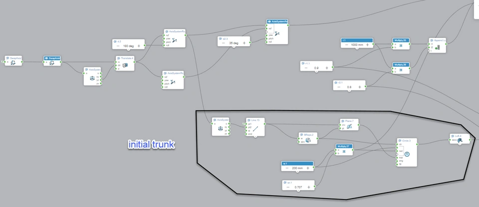

Initiate the model with the main trunk

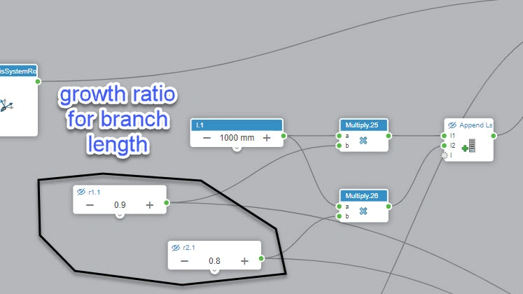

Then set the growth ratio for the branch lengths. I start with 1000mm and then depending on which branch, the length is different. this breaks the symmetry of the tree
then I create the trunk. the important task is to set the initial radius for the trunk, it will be used for the branches in the loop

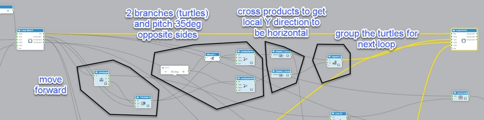

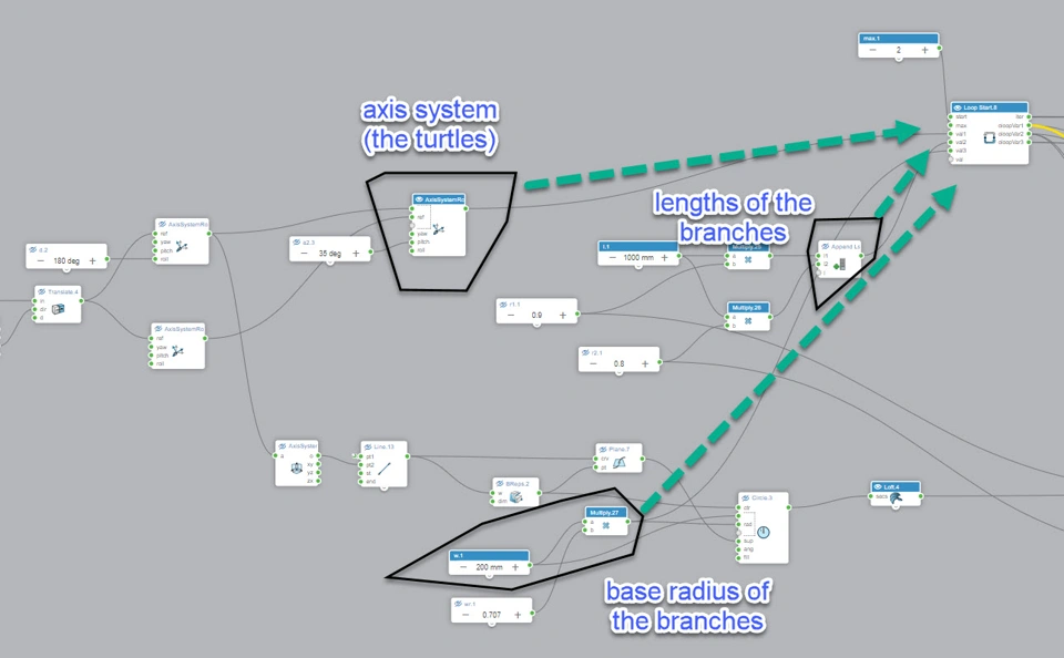

The loop has 3 inputs: the turtles / the branch lengths / the branch base radius
in the loop, let me focus on the Turtle input treatment. I follow L -system sympodial tree (B condition). as the A condition is done 1 time and corresponds to the initial trunk only! A condition is 1 time and never again.

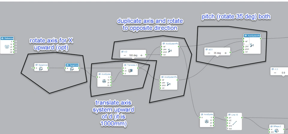

turtle is moved forward, then split into 2 and pichted opposite direction of 35 deg. you could also break the symmetry, there with 50deg/-10deg for example. then there is tricky part to align the turtle to the horizontal. I used cross product with vertical direction and made it a "user feature". group the split turtles and set them as new inputs.
about the 2 other inputs: length and radius. it is not complex. so I skip the explanation.

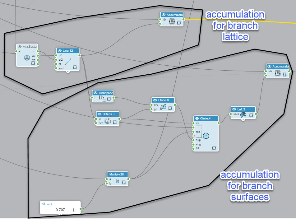

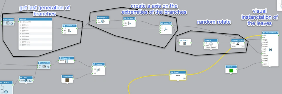

I set 2 accumulators: one for the branch lattice, to be used for the leaves and 1 accumulator for the trunk surface, which I wanted to use lattice for smooth surface but could not make it work yet.
Then I copy pasted an old script of flower that could be used as leave. it gives a nice level of complexity to the model.

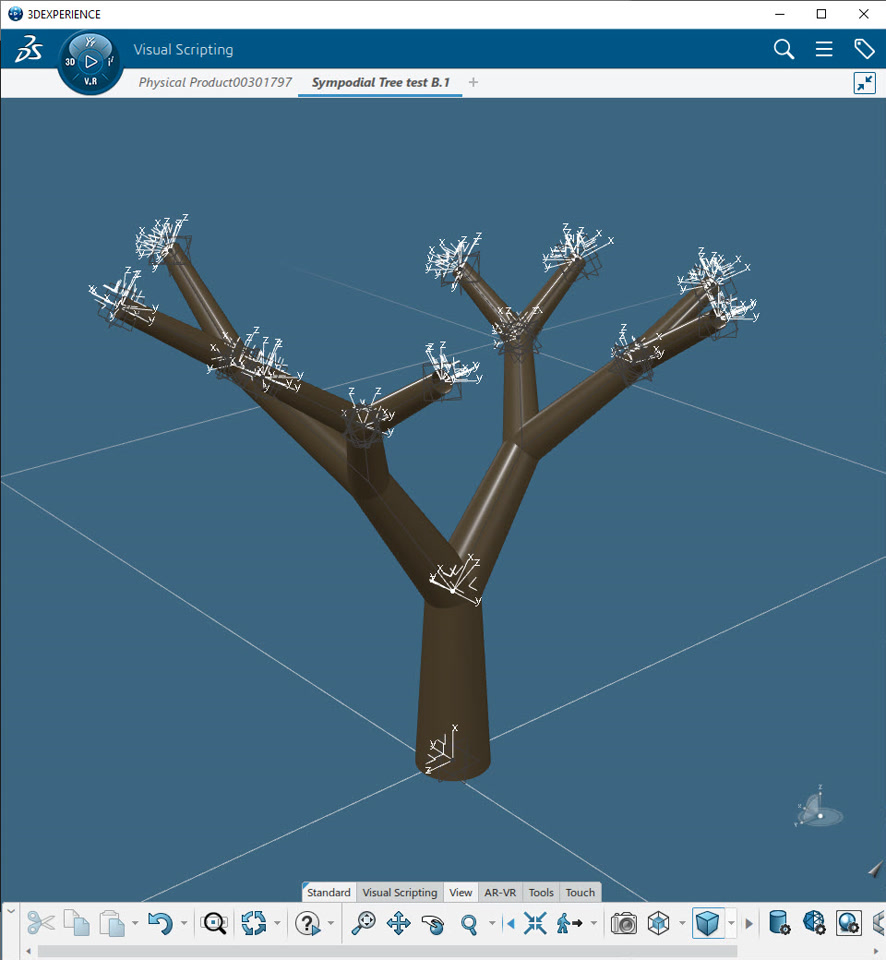

retrieving the extremities of the last generation of branches, I instanciated the flower to them.

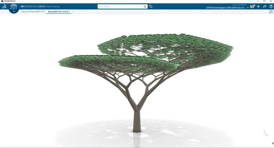

finished.

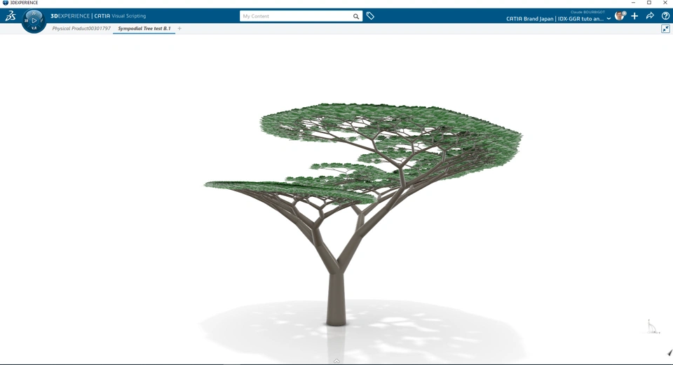

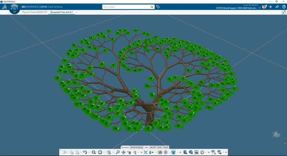

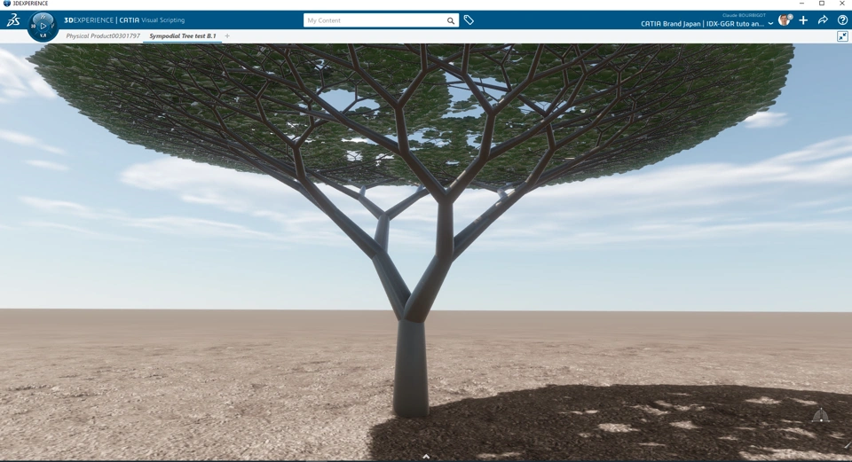

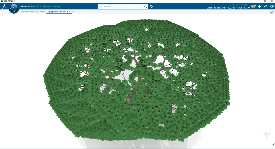

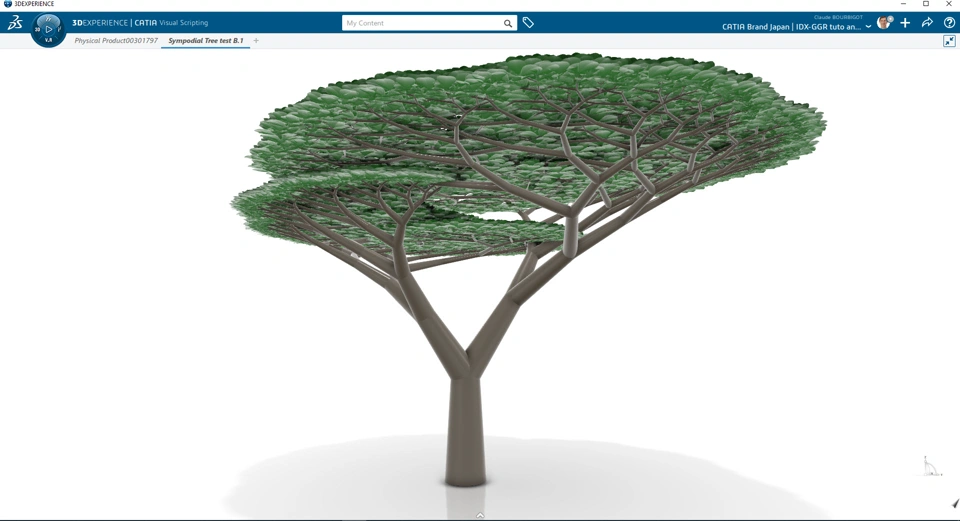

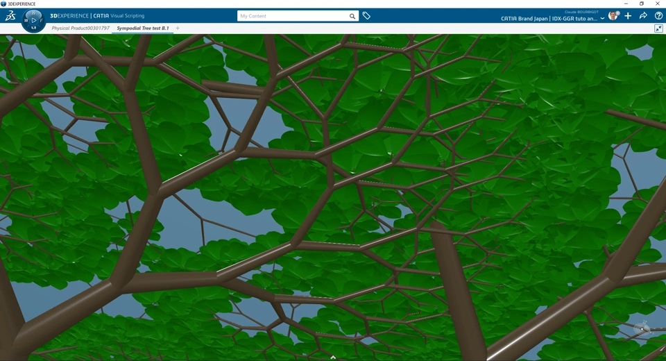

here are some rendering trials (Real Time, not global illumination or ray tracing) -> 12 generations of branches.
also, it takes 10 to 15s !!!! while 2 years ago, I recall minutes of calculation with no leaves. DSRD rocks.

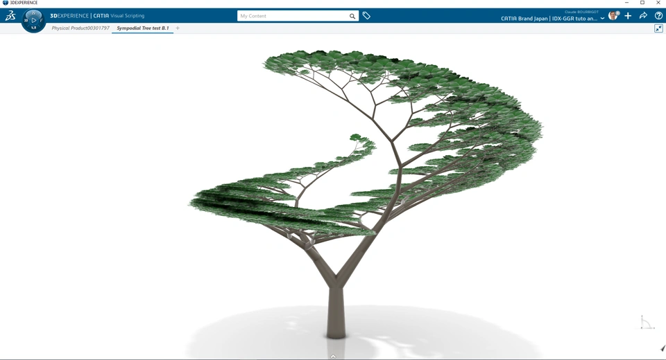

My favourite
