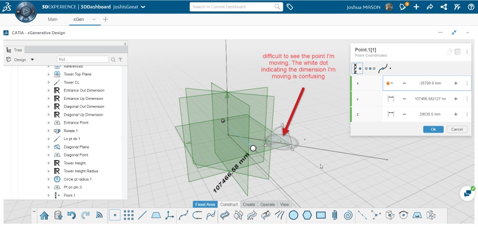

- Interactive robot slider of point - it's a little hard to understand which point I'm moving because the axis of movement is represented as a giant point. See attached.
