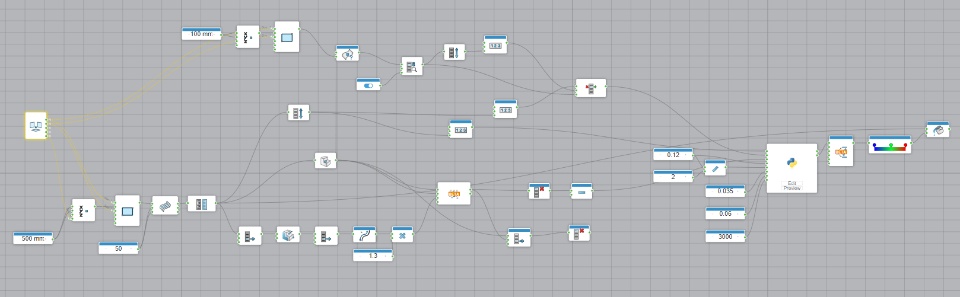

3 About Modeling

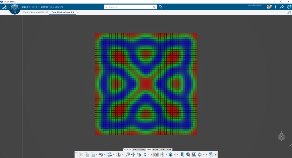

in this post I will use on a simple flat square surface and will share how to do with "complex surfaces" in another one.
overall size looks not so big
Here is my cooking recipe.

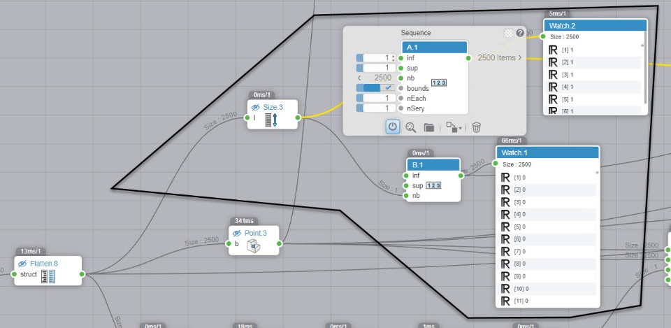

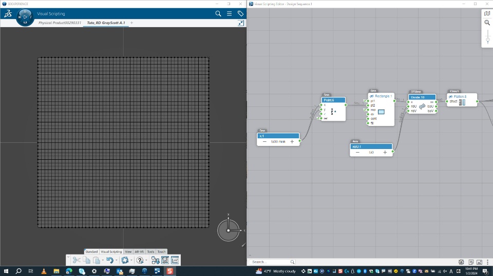

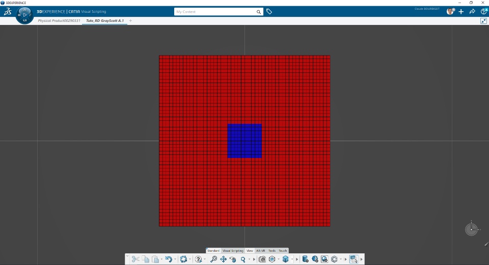

1. Create a Flat surface and divide it into little square surfaces.
Basically, I pixelized the surface 50X50 in the attached 3dxml. This surface is the "skin" to bear the Reaction Diffusion (RD) pattern. but the more the pixels, the better the effect. 150X150 is very good to me but it will take time to calculate.
2. I flatten the matrix of pixels, to get a single list. I found it easier to read.
3. Create a list of 1s of the size of the list of pixels, by using functions size and sequence. It corresponds to the A substrate's concentration. (it is supposed to be between 0 and 1, but in my model, it could go negative or diverge, so I must be careful on the Gray Scott parameters)
4. Create a list of 0s of the size of the list of pixels. it corresponds to the B substrate's concentration.
5. Initiate the reaction with a few B. for this, I created a square in the middle and set 1 in the B list at the index of
the pixels that are within the middle rectangle.

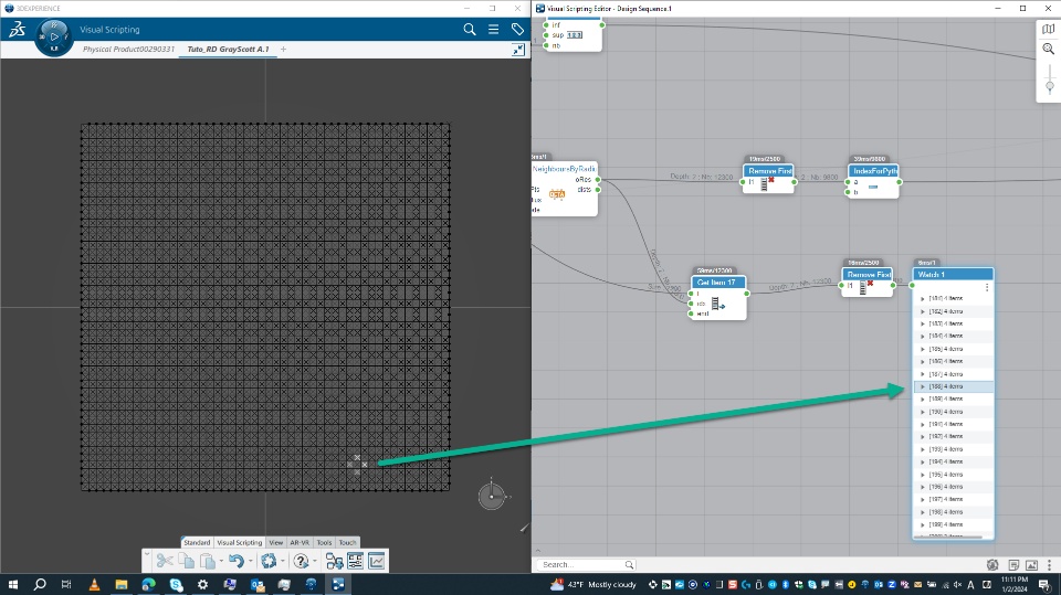

6. To prepare the calculation of the Laplacian, I select the neighboring points of all the points around the square. in this model, I take only the side pixels, not the corner ones.
maybe a link to understand Laplacian/Convolution (learnt at 18, "understood..." at 49...punaise):
 A simple image convolution (youtube.com)
7. I decrease of 1 all the numbers in the previous list, because in Python script, the indexation of a list starts at 0, while in Visual scripting list, it starts at 1.

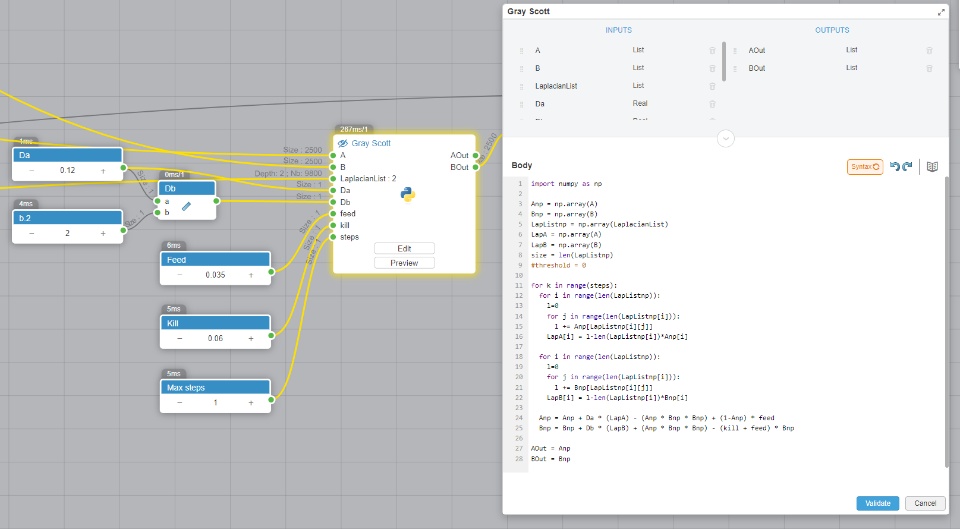

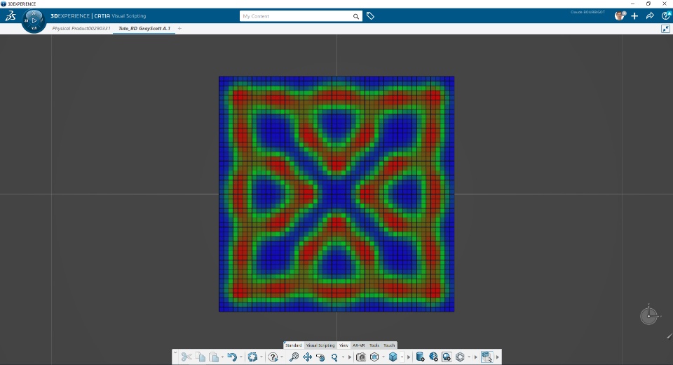

7. Gray Scott Python Script - with numpy
in addition to the A and B lists, my inputs are
  • Da (Diffusion for A): 0.12
  • Db (Diffusion for B) half of Da
  • Feed: 0.035
  • Kill: 0.06
  • 5000 steps in the loop of the attached 3dxml
Finding a "sweet spot" was not easy at all. this is where I started to ask ChatGPT for advice. it did not give me right numbers but more like encouragement to continue. also, how many steps... I thought 50 was enough, while Rohan told me that it could be few 10000!!!
about the laplacian. it is the sum of the neighbouring concentrations minus the central concentration multiplied by the number of neighbors used... in case of a pixel with 8 neighbours (all around), I do top pixel+bottom pixel+right pixel+left pixel - 4 X central pixel. the corner pixels are not used in this case.
here is the corresponding Python script
import numpy as np
Anp = np.array(A)
Bnp = np.array(B)
LapListnp = np.array(LaplacianList)
LapA = np.array(A)
LapB = np.array(B)
size = len(LapListnp)
for k in range(steps):
  for i in range(len(LapListnp)):
    l=0
    for j in range(len(LapListnp[i])):
      l += Anp[LapListnp[i][j]]
    LapA[i] = l-len(LapListnp[i])*Anp[i]
    l=0
      l += Bnp[LapListnp[i][j]]
    LapB[i] = l-len(LapListnp[i])*Bnp[i]
  Anp = Anp + Da * (LapA) - (Anp * Bnp * Bnp) + (1-Anp) * feed
  Bnp = Bnp + Db * (LapB) + (Anp * Bnp * Bnp) - (kill + feed) * Bnp
AOut = Anp
BOut = Bnp
8. rescale the result with "Scale Numbers" and colorize the initial pixels with "color gradient"
