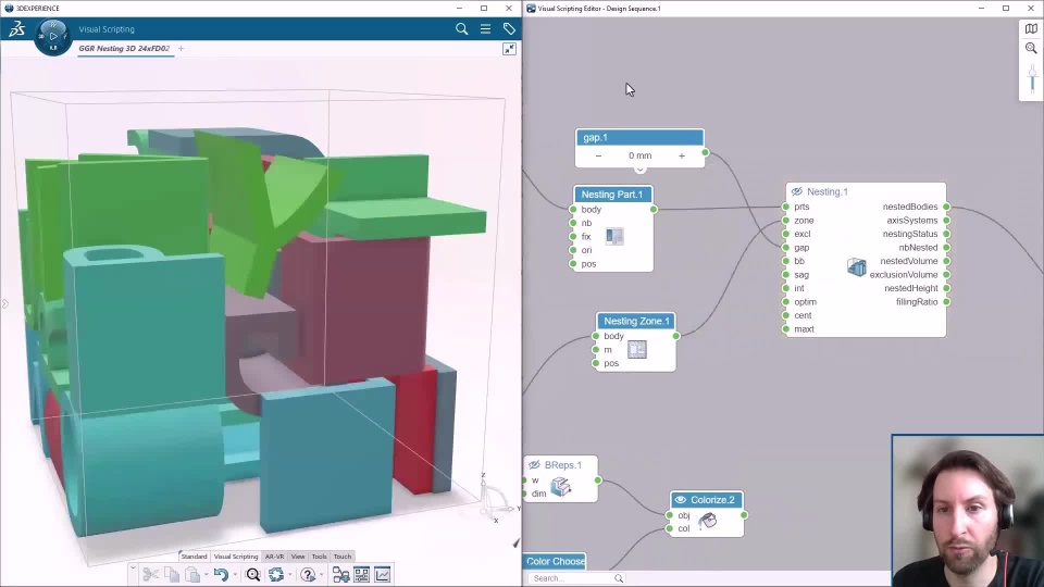

Nesting 3D Geometries
Four new operators let you pack 3D geometries on a 2D support or in a volume. Important: Working with nesting operators requires the Engineering Rules Capture app to be granted and installed. Those advanced operators are only available and compatible in CATIA Visual Scripting (not CATIA xGenerative Design)
Benefits: Automate efficiently the positioning of 3D objects onto flat surfaces or 3D volumes to improve manufacturing process and reduce material waste.

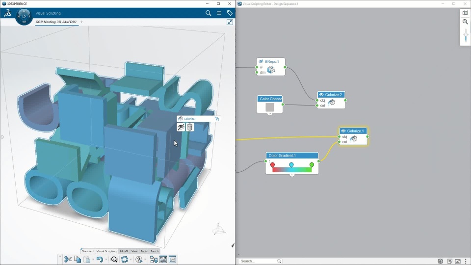

Instantiating and Publishing Visual Representations
New operators let you generate visualization instances of any visualizable entity. The position, rotation, scaling, and color of instances can be accurately controlled.
Benefits: Generate and publish huge quantity of visual instances in seconds, without computing the geometry.

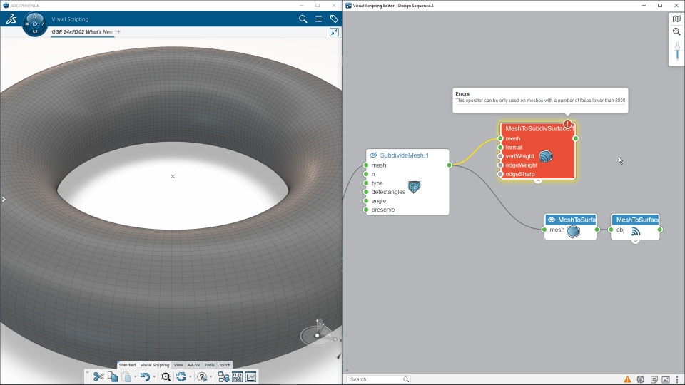

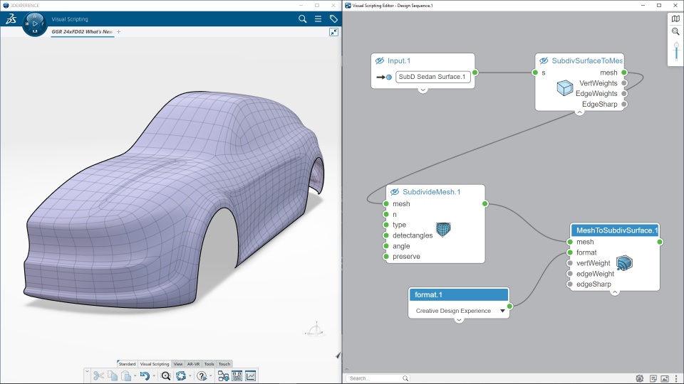

Working with Creative Design Experience
The Subdivision Surface to Mesh operator is improved to support as input the mesh base of a subdivision surface created in the Creative Design Experience app. Moreover, the Mesh to Subdivision Surface operator has a new format input that lets you select the format of the output surface: either Imagine & Shape or Creative Design Experience. Important: These operators are available provided that a specific app is granted and installed.
Benefits: Make the most of a seamless and integrated workflow between Creative Design Experience and Visual Scripting.
Generating a Surface from a Mesh
The new Mesh to Surface operator uses a mesh as input to generate a subdivision surface with an unlimited number of faces. Contrary to the Mesh to Subdivision Surface operator, Mesh to Surface has no editability capabilities. Important: This operator is available provided that a specific app is granted and installed.
Benefits: Extend your surfacic capabilities with the generation of smooth G2 surfaces.

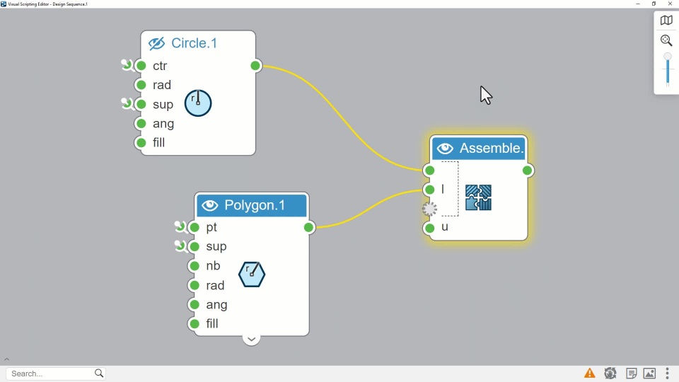

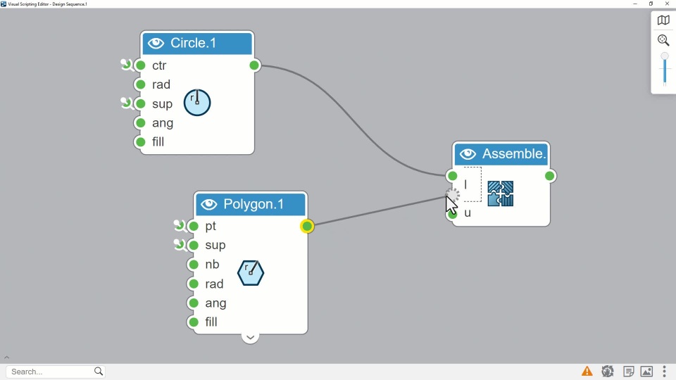

Activating Dynamic Connectors by Hovering a Connected Input
When you hover over an input connector that is already connected, a new connector is now automatically added to let you create a connection.
Benefits: Improve your productivity and speed-up your design process with improvements on the user interface.

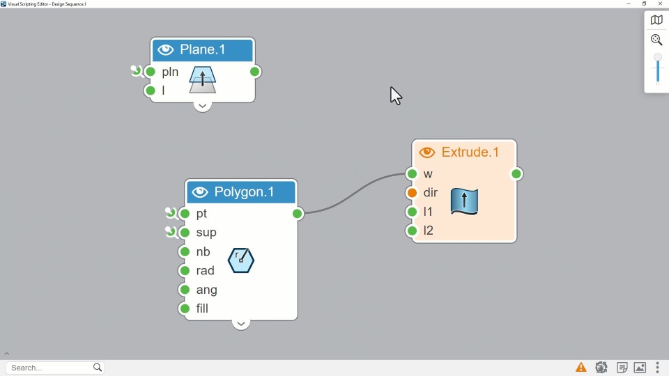

Hiding and Showing Geometries from the Header of a Node
In the editor, a new icon is provided to manage the display of operations that create geometries.
Dragging a Dataflow on a Node to Connect it
When you click and drag to connect an input or an output, dropping the dataflow over the node of an operation automatically connects the dataflow to the compatible connector.
