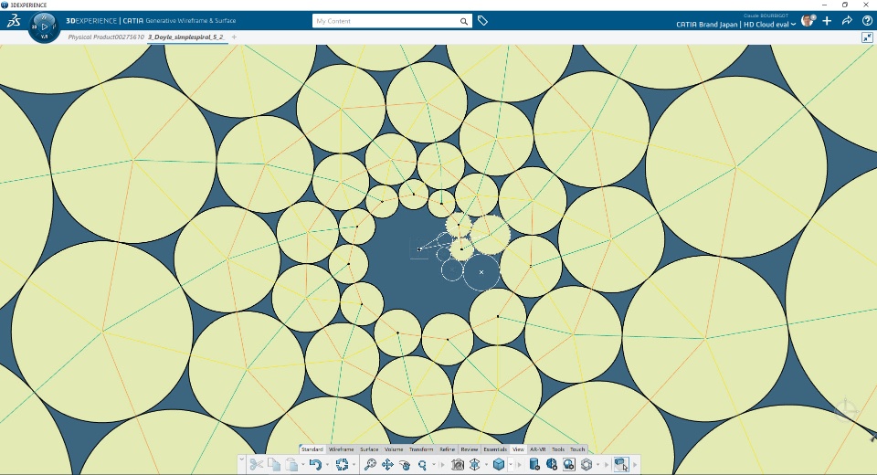

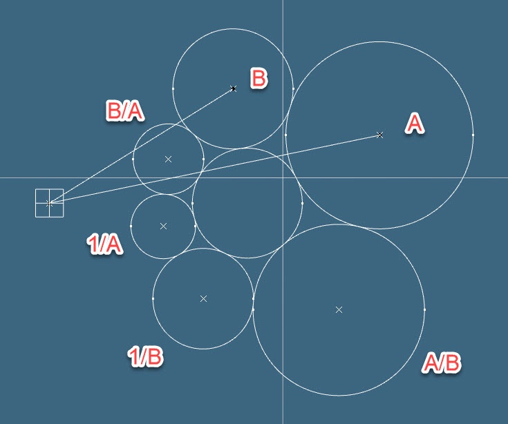

here is my methodo in Xgen/GGR

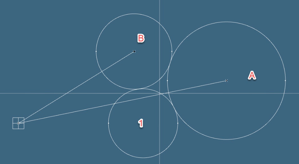

1. define the 3 base circles (1, A, B)
  • I do it manually for a given set of (p,q): (2,12) -> tuning "a , t , r" parameters in the 3dxml
  • you can find automatic ways in python or other languages. I need to check if possible to do it in Xgen / GGR -> would like other pairs
2. define the remaining base flower (B/A, 1/A, 1/B, B/A)

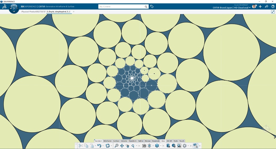

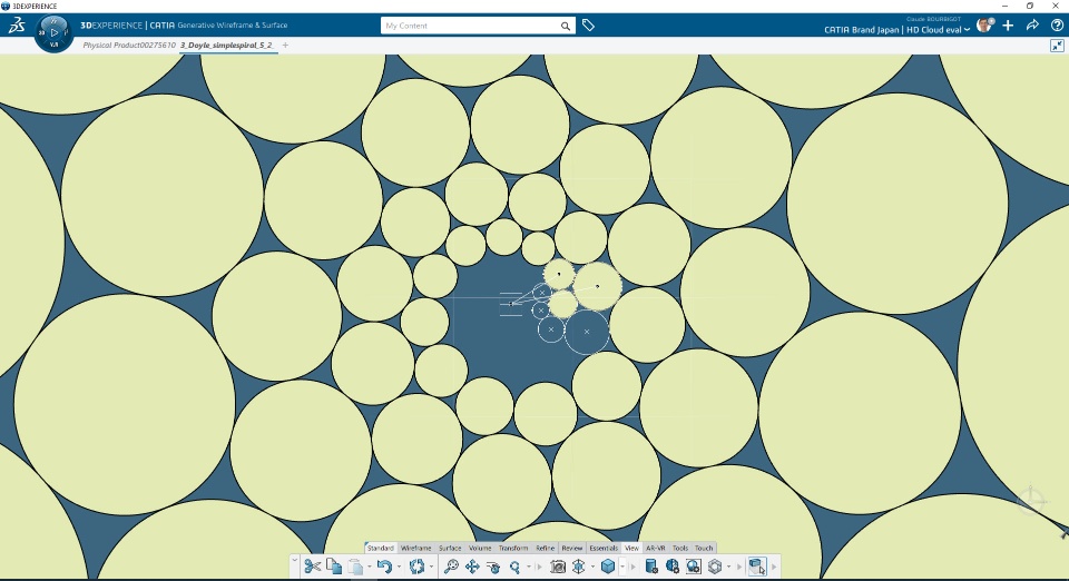

3. create the outer big spiral from A and B
4 create the inner smaller spiral from B and B/A
  • in the model, I dont use it because too small

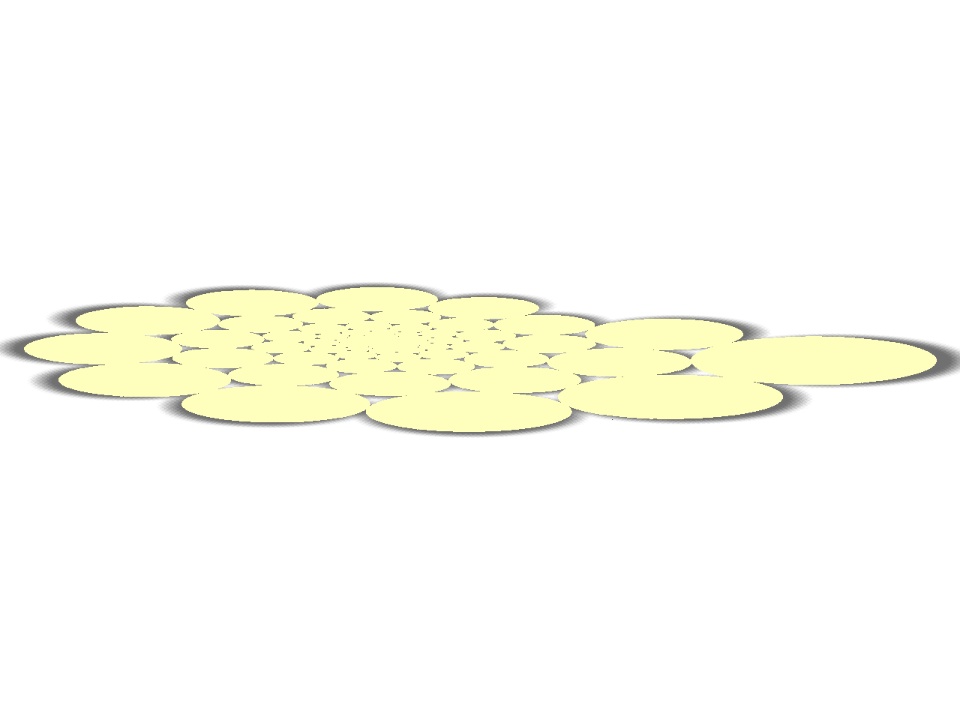

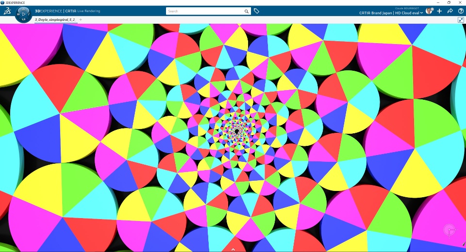

6 slice the disk with the spirals
7 set the colors
