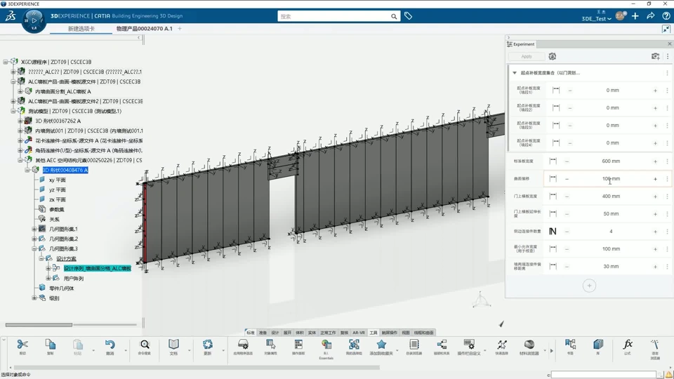

The original geometric surface of partition walls serves as the core geometric input, while adjustable parameters such as surface offset and standard wall panel width are configured to build the automatic surface segmentation logic:
  1. Batch split the partition wall surface according to the preset panel width to generate subdivided surfaces of standard dimensions;
  2. Automatically verify the width of each subdivided surface; areas narrower than the minimum allowable width will be highlighted in red for quick identification of non-compliant segments;
  3. Simultaneously create positioning coordinate systems required for component assembly;
  4. Publish and output the subdivided surfaces, bottom edges of surfaces, and positioning coordinate systems uniformly for calls by subsequent modules.

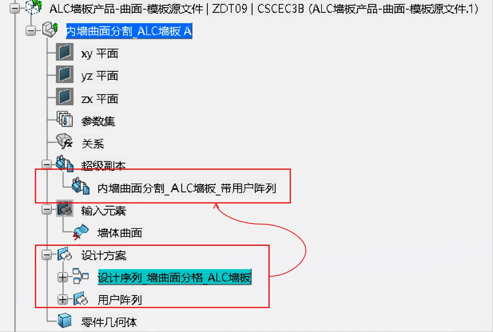

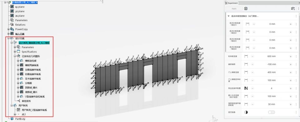

Create a User Pattern custom array template based on the positioning coordinate systems output by the script. For unified management, it is recommended to collect the visual scripting program and User Pattern template into the same graphical set (example name: 设计方案).
III. Process Encapsulation: Standardized Assets via Power Copy
After debugging the full logic of surface segmentation and coordinate system generation, encapsulate the workflow into a standardized Power Copy template with the partition wall surface as the sole input condition.
Templates can be archived and managed uniformly in the Catalog Directory Browser, enabling quick access by team members and reducing redundant modeling costs.

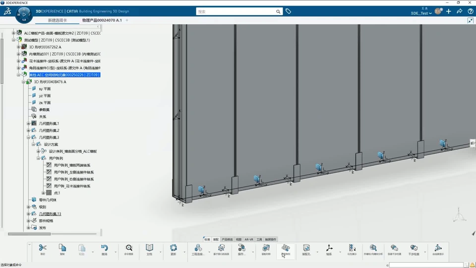

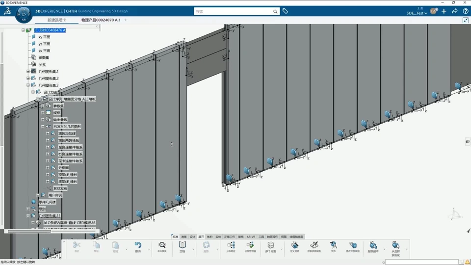

After completing the basic surface modeling of internal walls, other designers can directly call the encapsulated Power Copy to generate all intermediate geometries with one click, including split surfaces, positioning edges, assembly coordinate systems and custom array templates.
Based on the automatically generated positioning references, batch modeling can be rapidly completed in two steps:
  1. Instantiate the standard template of internal precast wall components relying on positioning lines to generate wall panel models in batches;
  2. Utilize the Assembly pattern function to automatically arrange all U-shaped connecting fittings along the positioning coordinate systems.
