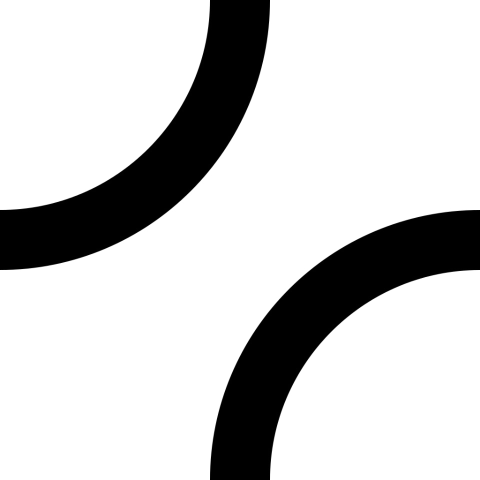

Truchet Tiles are square tiles decorated with patterns that are not rotationally symmetric. When placed in a square tiling of the plane, they can form varied patterns.
https://en.wikipedia.org/wiki/Truchet_tiles
You choose your set of "Truchet" tiles and rotate them the way you like,while paving the wall.
I chose the Quarter-Circle tile: two quarter-circles connecting the midpoints of adjacent sides.
Usually, Truchet Tiles are on a plane! I wanted to tile on a surface. As far as a curvilinear coordinate ( U V) system can be used for a surface, you can feel safe.
Algorithm
1. Divide surface (by its U and V) -> you got the pavement and tile system
2. for each tile of the pavement
- get the list of edges (4 edges)
- Shift the list of 0 or 1 randomly
3. for each edges
- Get mid point
- create a segment orthogonal to the edge toward the exterior of the tile
4. create a connect curve between point 1 and 2 of the tile and tangent to the segments of step3
5. create a connect curve between point 3 and 4 of the tile and tangent to the segments of step3
6. circle sweep the curves
