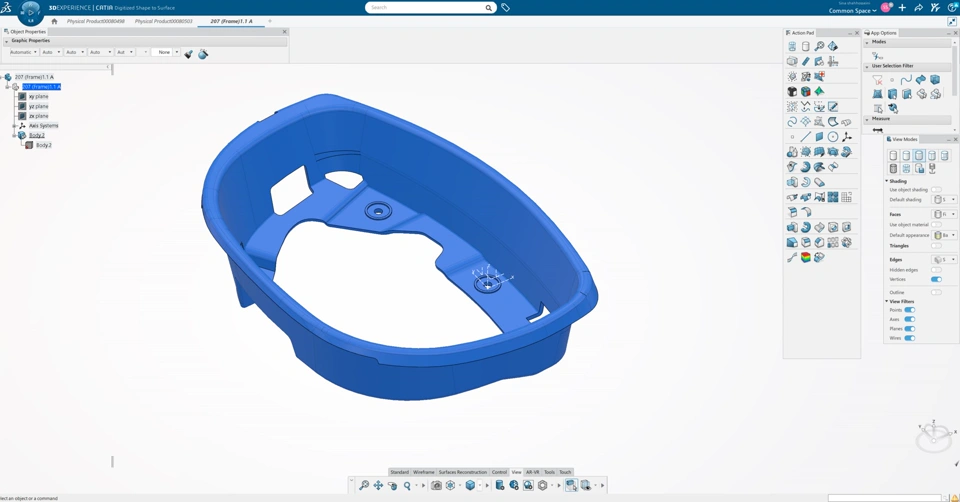

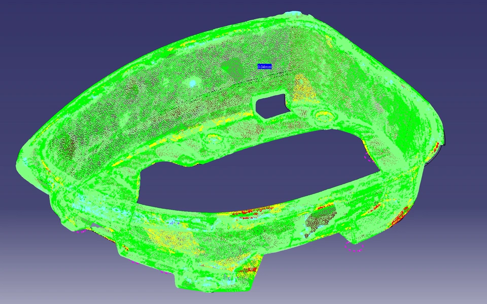

I recently worked on the reverse engineering of the Peugeot 207 side mirror frame, and this video is a short walkthrough of the process.

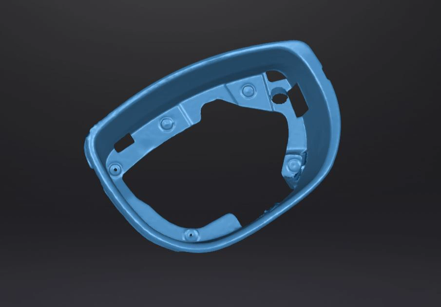

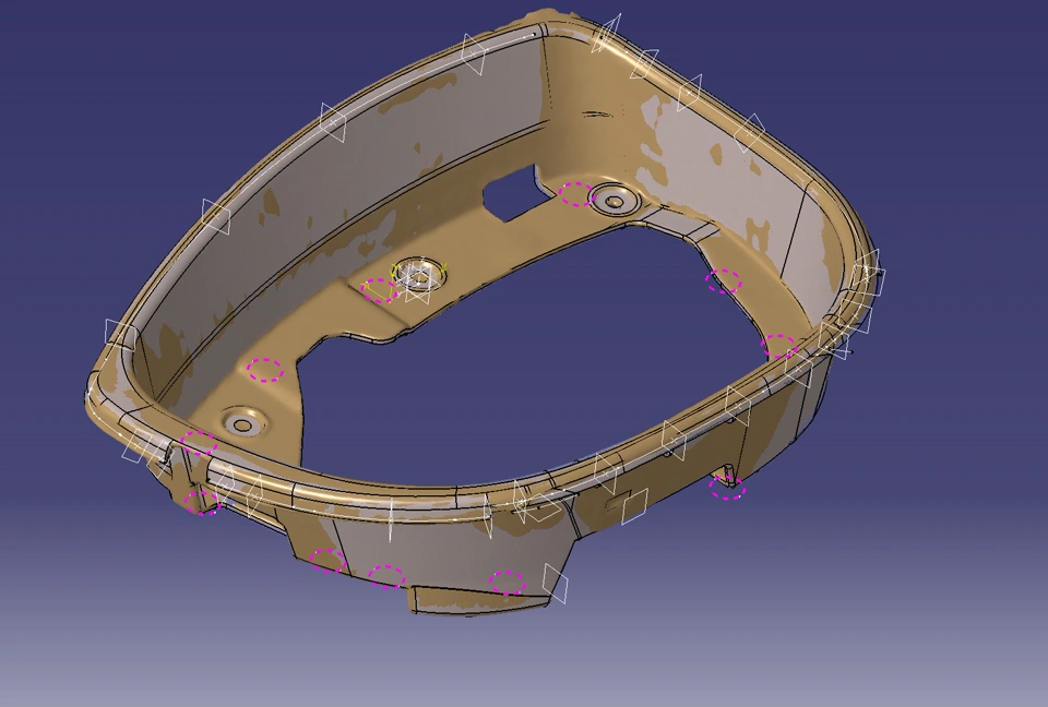

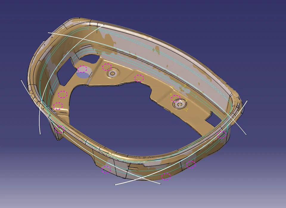

From 3D scanning the real part, to accurate CAD reconstruction in CATIA / 3DEXPERIENCE, and finally validating the geometry with a 3D-printed prototype.
🎥 In this video you’ll see:

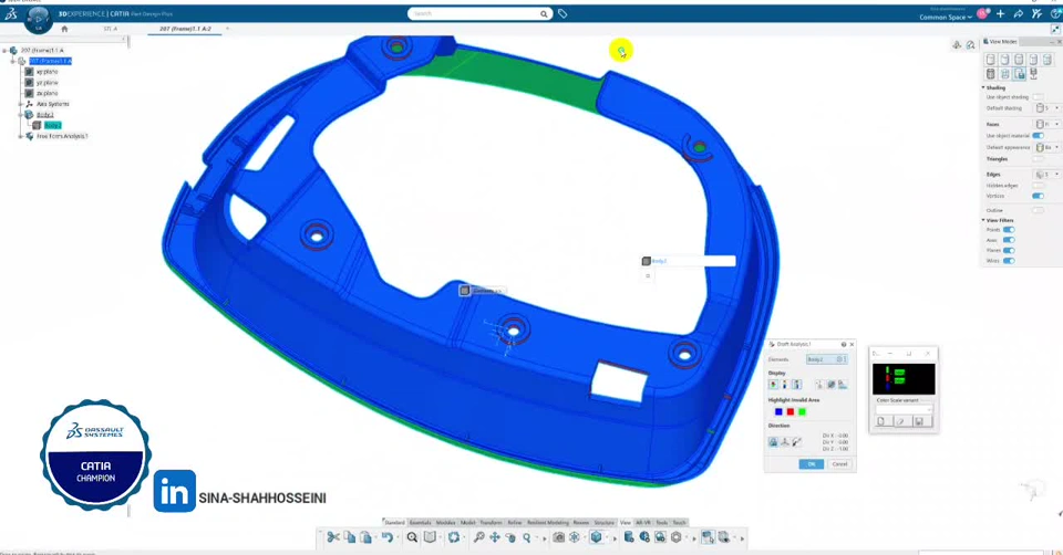

The part reviewed in a 3D environment
Comparison between the real component and the CAD model
The final reconstructed geometry

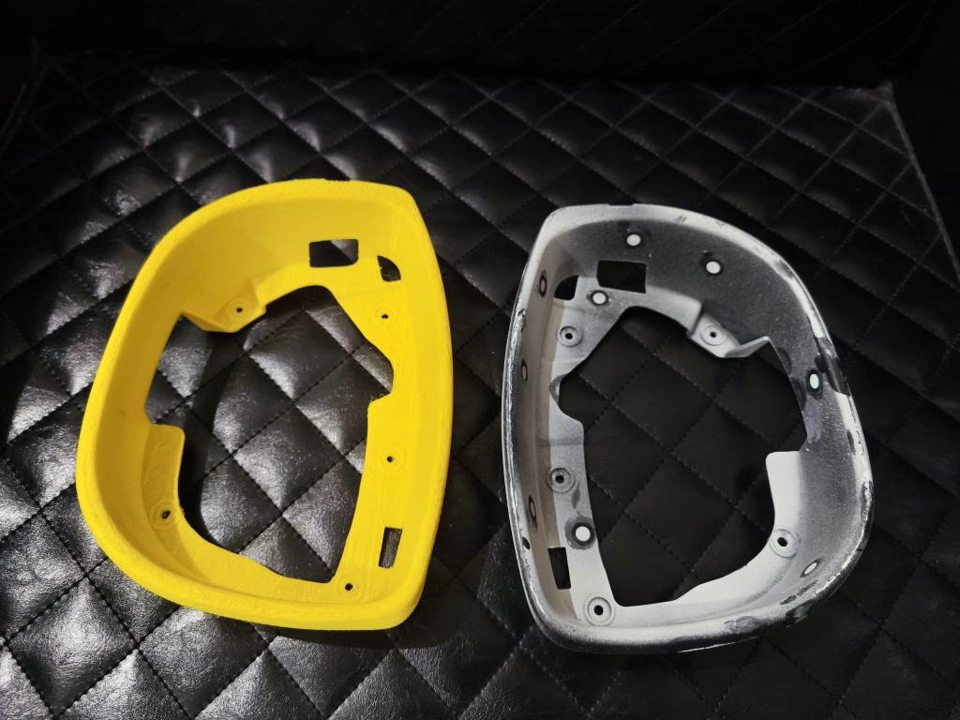

And at the end, the 3D-printed sample used for fit & form validation
This project wasn’t just about modeling.
The main focus was geometrical accuracy, design logic, and preparing the part for injection mold design.
