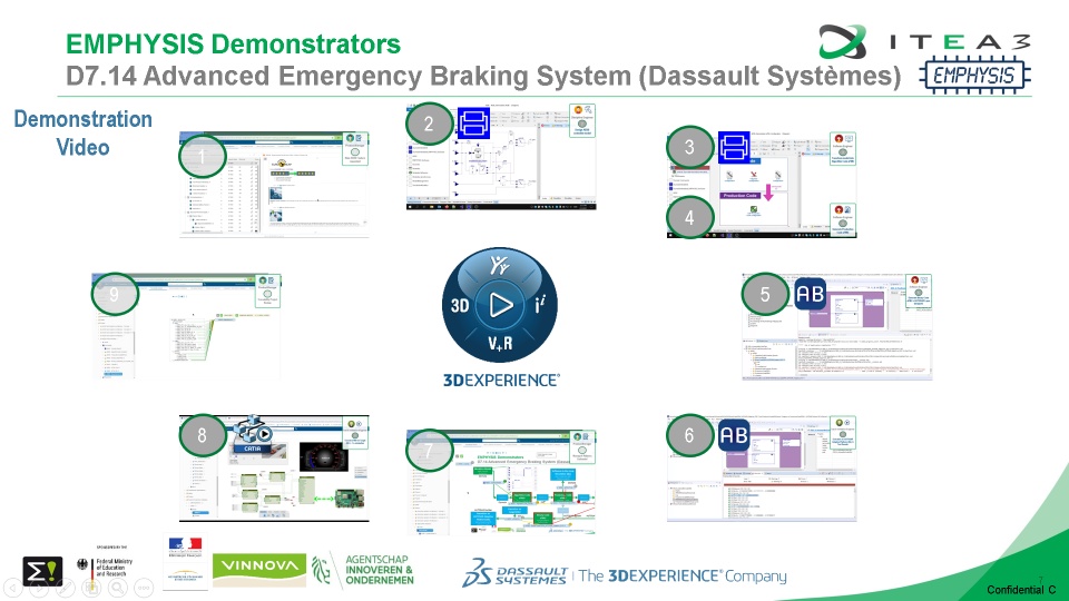

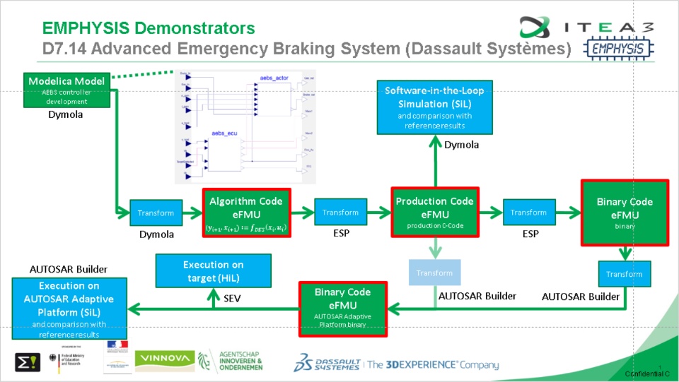

3. The whole eFMI workflow runs in a 3DEXPERIENCE based demo
Additionally, DS made a large illustration of eFMI support with all DS tools in the full eFMI workflow, and within 3DEXPERIENCE platform. The idea is here to show how a project could be supported along different stages.
This case is illustrated in this AEBS demonstrator :
EMPHYSIS – Overview of DS major demo with 3DEXPERIENCE integration 1/2
EMPHYSIS –  Overview of DS major demo with 3DEXPERIENCE integration 2/2
