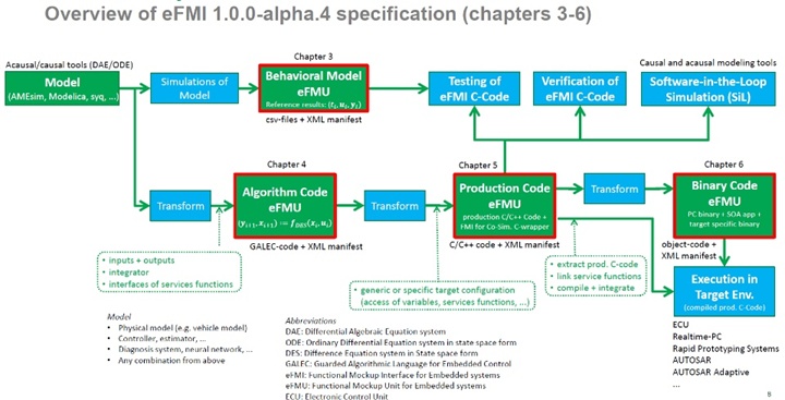

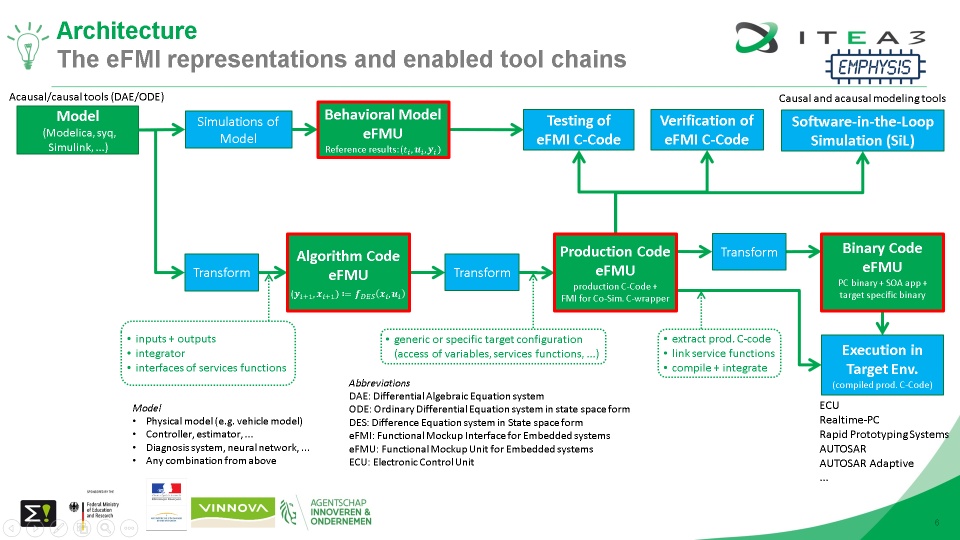

eFMI enables both the representation and storage of systems components with models transformed in successive stages:
  • Behavioral initial model : Behavior model with reference results derived from original (a-)causal physics/control model (eg Modelica, Simulink)
  • Algorithm Code : Discretized, causal, algorithmic, upper-bounded solution for original physics/control model (may contain embedded integrators)
  • Production Code : Generic or target specific C code, with access / services functions for embedded system integration
  • Binary Code : Binary representation to run on specific HW targets
  • Description is done through manifest files
  • Multiple stages can be included in the same eFMU container
  • the existing FMI standard is  supported

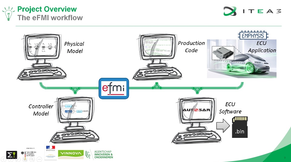

EMPHYSIS – Concept of the eFMI workflow
EMPHYSIS – detailed eFMI workflow
EMPHYSIS – Overview of eFMI specification (260 pages)
eFMI specifications - chapters and content
eFMI Specifications  - Version 1.0.0-alpha.4
