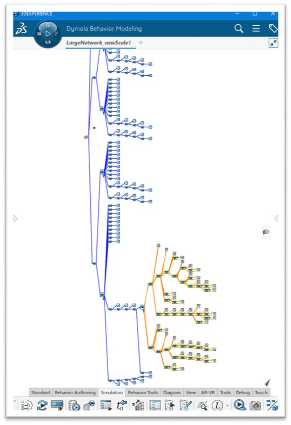

Modelling a large electrical network in CATIA 3DEXPERIENCE

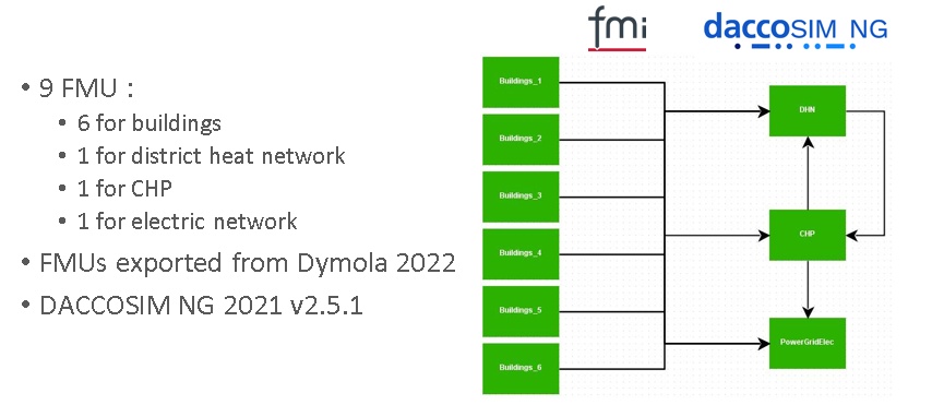

Co simulation of EDF Power Grid with Dymola (3DS) and DACCOSIM (EDF)

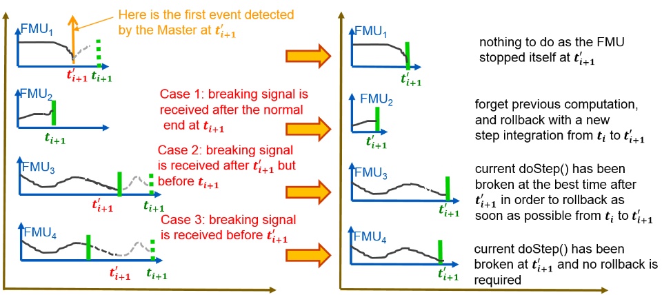

3 evolution proposals have been proposed on the FMI standard, to be part of the future V3.0 major version :
  • Early Return functionality
  • Flow causal connectors
  • BreakStep feature
with 2 topics accepted by the Design Committee
Different synchronization scenarios between parallel FMUs
