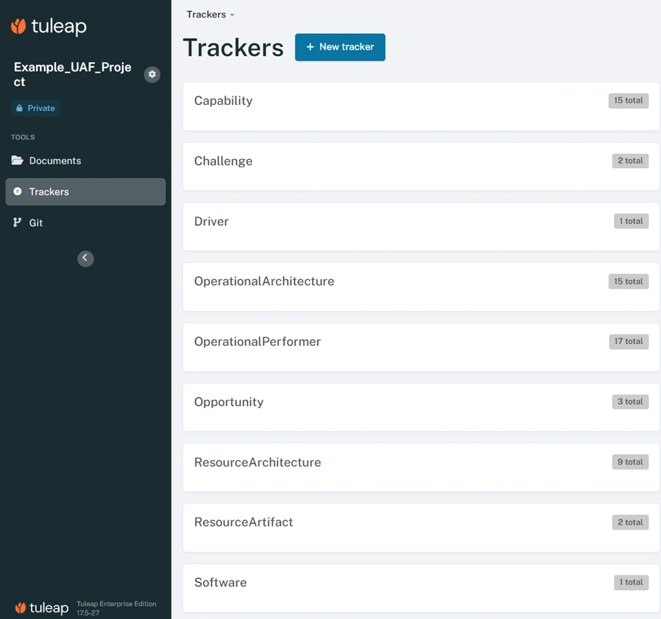

For this demonstration, I configured a dedicated Tuleap UAF project with the following:

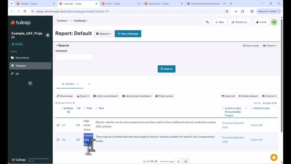

  • Trackers corresponds to UAF element types (e.g. Capability, Driver, Challenge, etc…)
  • Artifacts represent individual UAF elements

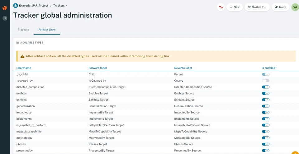

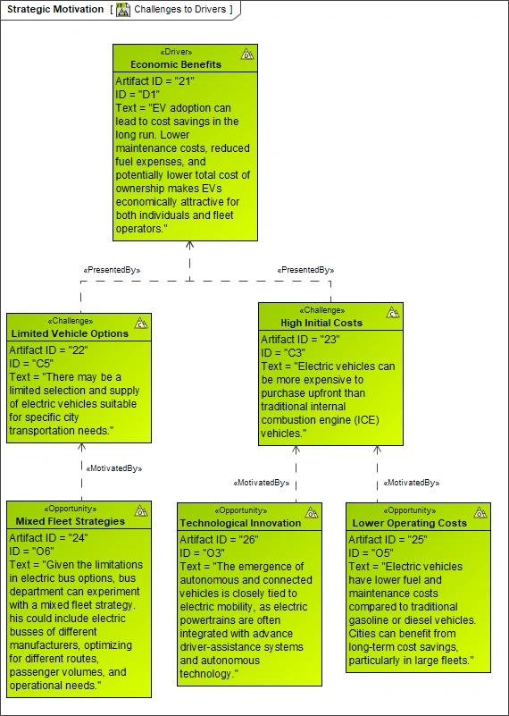

  • Artifact links represent relationships between model elements (e.g. MotivatedBy, PresentedBy, Generalization, etc…)
The example UAF Tuleap project can be reused as a template for other new Tuleap projects. A project created from this template receives the base Tracker structure and views. Custom artifact links must be configured in the new Tuleap project before importing the template.

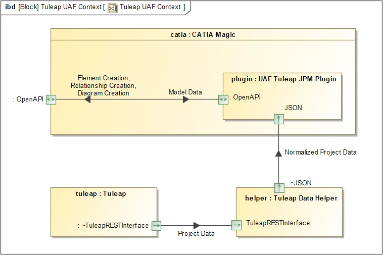

A custom plugin retrieves information from the Tuleap project and transforms it into native UAF elements, relationships, and diagrams in CATIA MAGIC. The current implementation supports a one-way flow from Tuleap into CATIA Magic.

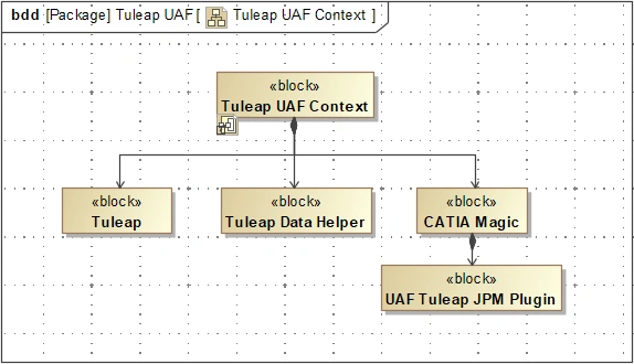

Solution Context:
Tuleap: ALM Platform where users can contribute and connect artifacts in their project
Tuleap Data Helper: Retrieves Tuleap project data and normalizes the data for the plugin
UAF Tuleap JPM Plugin: Transforms the Tuleap project data into UAF elements
CATIA Magic: Contains the model where UAF elements are created

  • Creating and linking artifacts in Tuleap

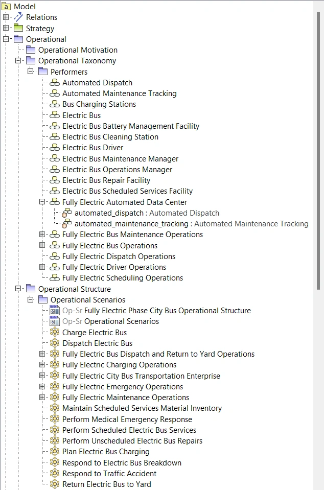

  • Importing artifacts and relationships into CATIA Magic

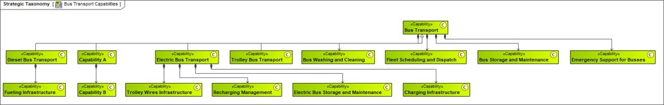

  • Generating UAF elements and diagrams
  • Demo results for Strategic, Operational and Resource domains

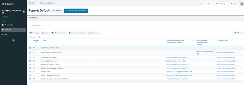

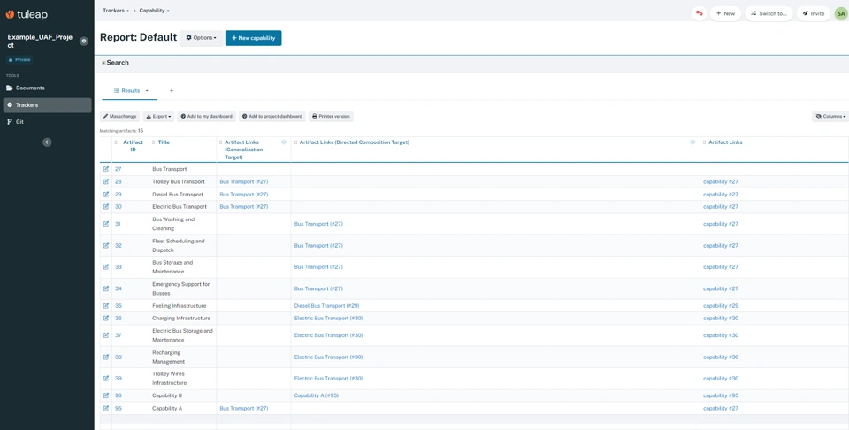

Trackers Overview

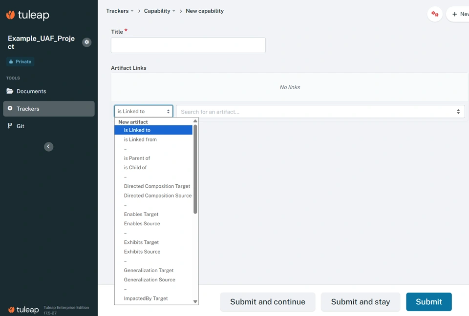

Capability Tracker
Create New Capability

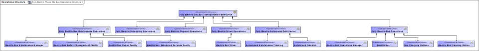

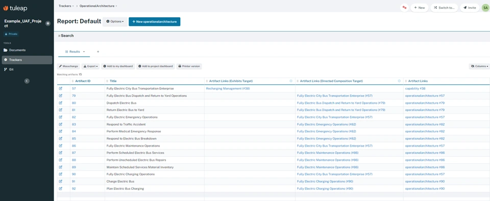

Operational Architecture Tracker
Resource Architecture Tracker
Artifact Links (e.g. the relationships)

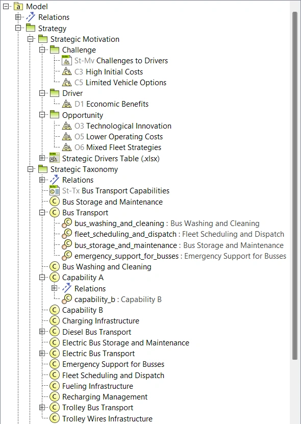

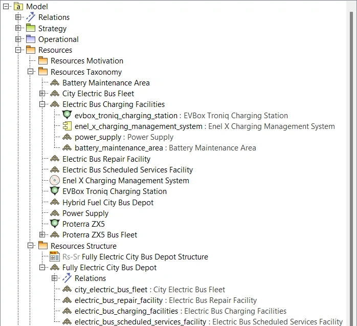

CATIA Magic

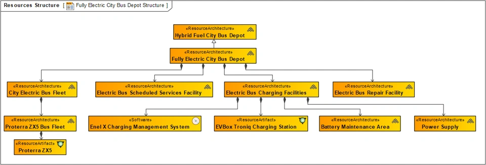

Domain Containment Tree Example Diagram Example
Strategy
Operational
Resources

Tuleap’s configurable tracker framework allows the project schema to be adapted for different modeling needs. Project administrators can configure:
  • New tracker types representing additional model-element types
  • Custom fields representing element properties
  • Artifact-link types representing relationships between elements
For automatic import into CATIA Magic, any new types, properties, or relationships must also have corresponding mappings in the integration/plugin.
