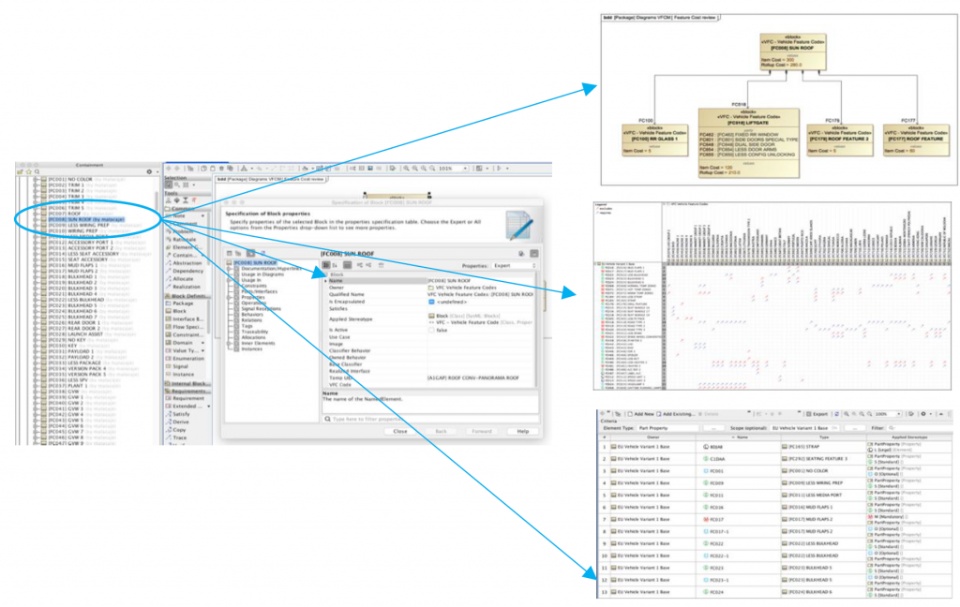

Fig2. Automatic Propagation of the Feature Change in the SysML Model

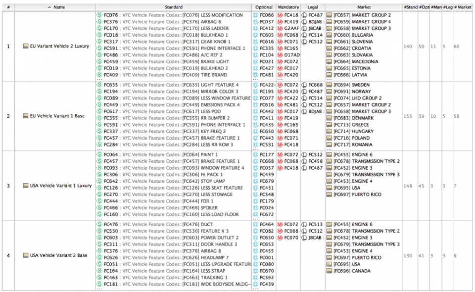

Fig 3. Vehicle Variants Feature and Markets Summary Table

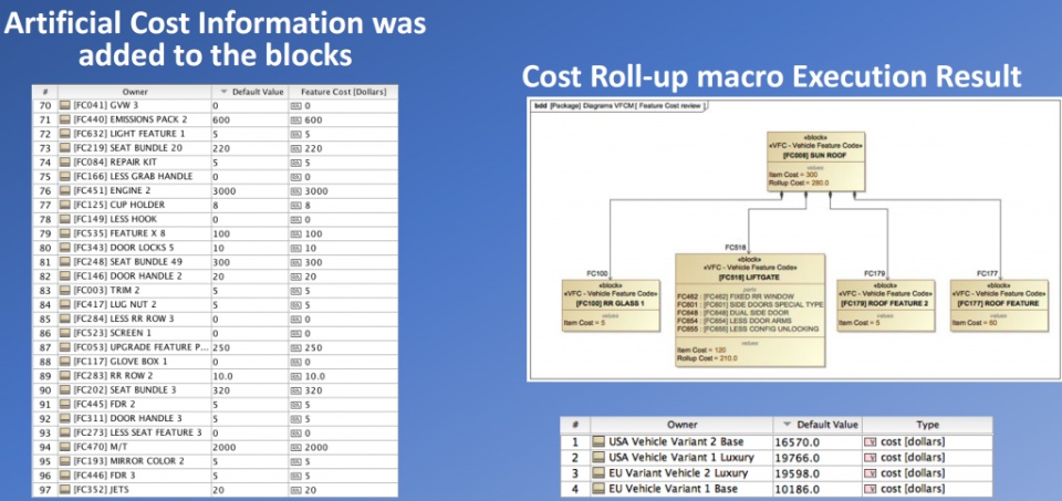

Fig 1. Cost Roll-up

The system modeling of the VFCM opens new possibilities to expand the current functionality to integrate other processes as we have reviewed with the Cost Roll-up Analysis which uses the existing model to produce new valuable information for the stakeholders. Beyond what we have discussed in this project there is still a wider field to expand the capabilities for creating new reports or model tools to attend to specific needs of VFCM users like functional or engineering attribute teams, marketing and finance teams.
