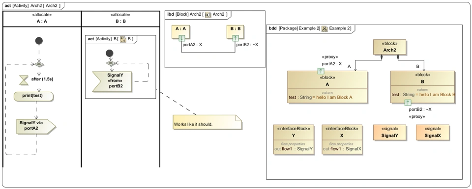

This is fine, until we get fancy and want to use events and use the ports to flow the events between the parts. Unfortunatly the send signal works, but the accept signal never arrives at its destination. Here is an example:
Why don't accept events work in a swimlane? The core reason is that the accept event is actually owned by the owning activity, not the context of the swimlane.

Simply we should never use swimlanes once we start to create executable models. We can get away with a slight hack. In the following we display the Activity owned by the block of the swimlane in that context. This will work, but as stated, this is a bit of a hack and the first swimlane creates an ambiguous model where behavior could be in the block 'and' wherever there is a swimlane showing the block.
