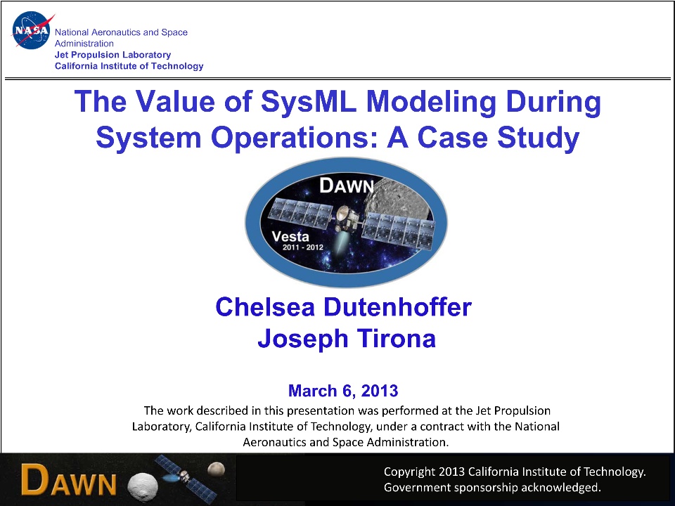

The Value of SysML Modelling During System Operations: A Case Study
Research conducted by Jet Propulsion Laboratory (NASA JPL) and California Institute of Technology, demonstrates the use of SysML in modelling the Ground Data System (GDS) for the Dawn spacecraft. The case study briefly discusses the advantages of a SysML model over an MS Excel® spreadsheet and also mentions how a similar GDS model could be used for other missions as well by just making a few changes to the original model, which would enable reusability and reduce design time.
System models are often touted as engineering tools that promote better understanding of systems, but these models are typically created during system design. The Ground Data System (GDS) team for the Dawn spacecraft took on a case study to see if benefits could be achieved by starting a model of a system already in operations. This paper focuses on the four steps the team undertook in modeling the Dawn GDS: defining a model structure, populating model elements, verifying that the model represented reality, and using the model to answer system-level questions and simplify day-to-day tasks. Throughout this paper the team outlines their thought processes and the system insights the model provided.
