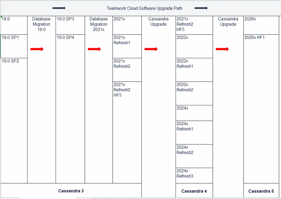

Teamwork Cloud Software Upgrade Path
The official Teamwork Cloud documentation contains a Teamwork Cloud Software Upgrade Path chart that shows the supported migration path across Teamwork Cloud versions and the associated Cassandra generations.
The documentation specifically states that you can upgrade directly between non-consecutive Teamwork Cloud versions. What you cannot skip are required database migration or Cassandra upgrade steps between the source and target versions.
Official documentation:
Teamwork Cloud — Upgrade and data migration
For a migration from 2022x to 2026x, the Cassandra requirement is straightforward.
Teamwork Cloud 2022x uses Cassandra 4, whereas Teamwork Cloud 2026x requires Cassandra 5.
Therefore, as part of the migration, Cassandra must be upgraded from Cassandra 4 to Cassandra 5.

Recommended 2022x → 2026x Refresh 1 Migration Approach
At a high level, I recommend approaching the Teamwork Cloud migration as follows:
  1. Back up the existing Teamwork Cloud database. Before beginning the upgrade, create a good, verified backup of the existing Teamwork Cloud/Cassandra database. For a production environment, I strongly recommend verifying the backup and restore process before beginning the migration.
  2. Upgrade Cassandra from Cassandra 4 to Cassandra 5. Teamwork Cloud 2022x uses Cassandra 4, whereas Teamwork Cloud 2026x requires Cassandra 5. Therefore, Cassandra must be upgraded from Cassandra 4 to Cassandra 5 as part of the migration.
    The product documentation provides a Cassandra installation script and recommends using it to install and configure Cassandra. The script installs the necessary Cassandra packages and tools, creates the required firewall rules, and installs the required Java version.
