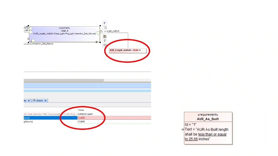

Sorry about the screen shot delivery, i'm hoping I'm providing enough info.
My Eqn_9 is calculating the AUR as built length and then the requirement is tied to that value.
are the trailing zeros (25.6600 causing cameo to think the length does not meet the req?, if a change one of the values to get the measure shorter that 25.6600 in any way the value goes "green"
- Is there a way to "round" the results of a eqn to, two digits past decimal.

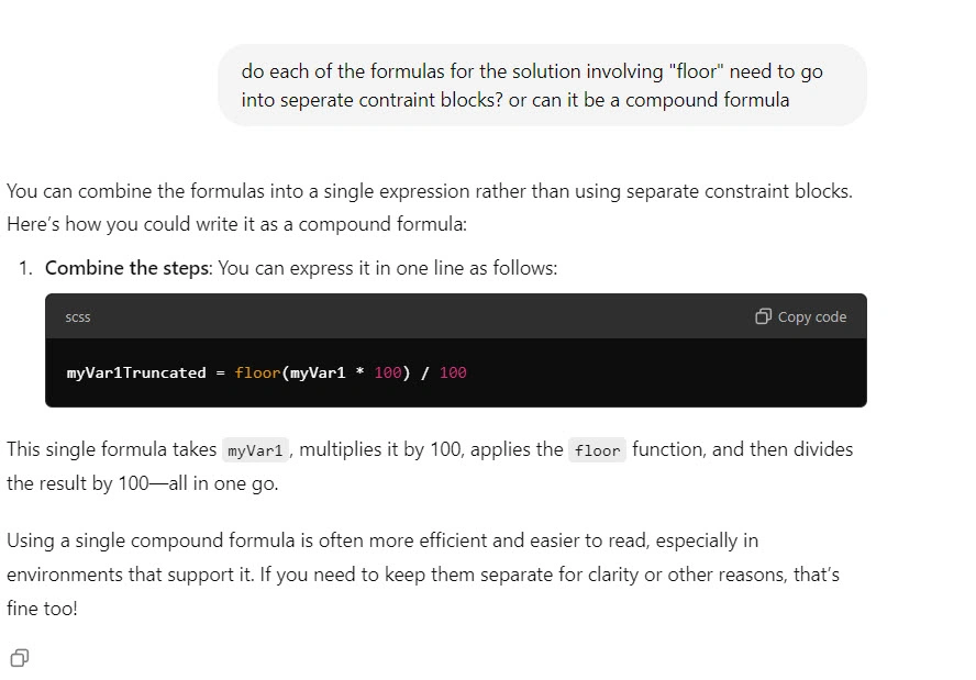

SOLUTION (ONE OF) using version 2021x R2
Using the "floor" to truncate (as opposed to rounding ) the result is still 4 places past decimal .
