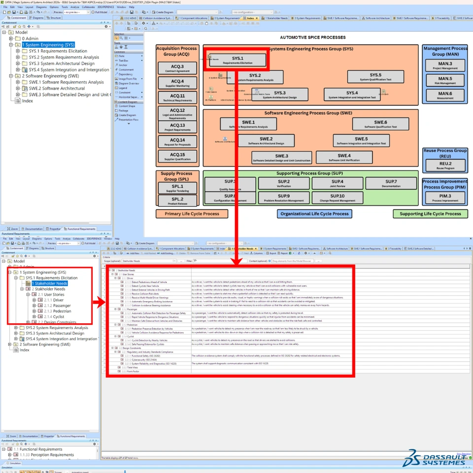

SYS.1 — Requirements Elicitation: Stakeholder Needs table with user story structure per actor (Driver, Passenger, Pedestrian, Cyclist) and design constraints referencing ISO 26262, ISO 21434, ISO 14229. Native model view — not a document.

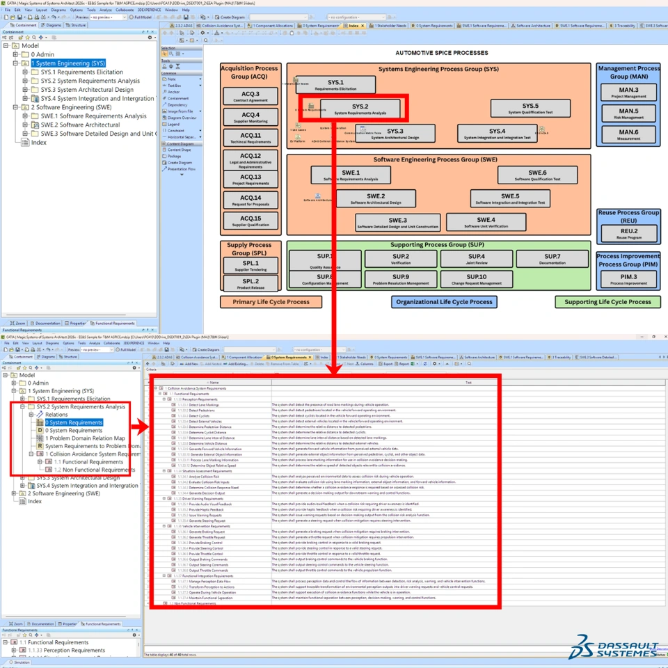

SYS.2 — System Requirements Analysis: System Requirements table using sysml:Requirement stereotype, organized into functional and non-functional categories. 40+ requirements, all traceable to stakeholder needs via Derive/Satisfy. Requirements exist as model elements with bidirectional traceability.

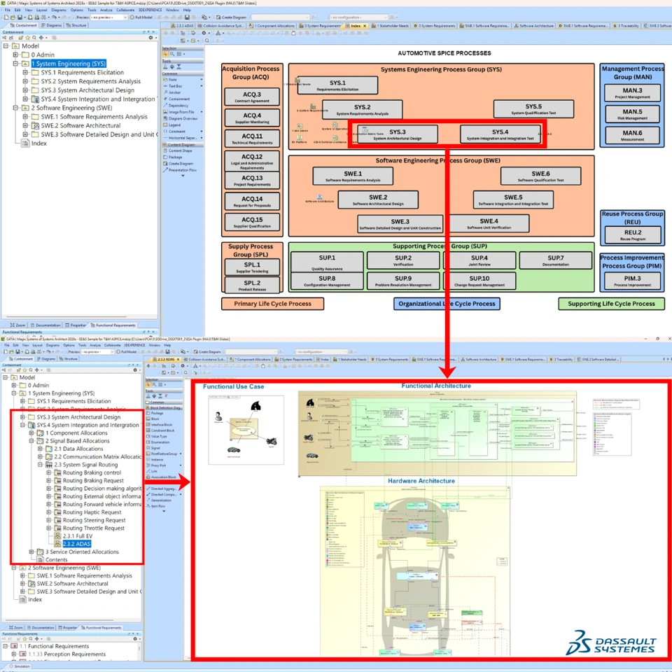

SYS.3 — System Architectural Design: Three synchronized views — Functional Use Case, Functional Architecture (EEFunction + EEFunctionalFlow + EEFunctionalPort), Hardware Architecture (ElectronicControlUnit, Sensor, Actuator, CANBus, Switch, VirtualLocalAreaNetwork). Full EV ADAS topology: Front/Rear Camera, LIDAR, Radar → LANSeries Ethernet switches → Zonal ECUs → Central ADAS ECU over CAN ADAS, VLAN 10/20.
SYS.4 — System Integration: Component allocations, signal-based allocations (CAN_ADAS + ETH_ADAS matrices), end-to-end signal routing (producer → physical path → consumer), SOME-IP service deployment on Ethernet, Ethernet port IP configuration matrices.

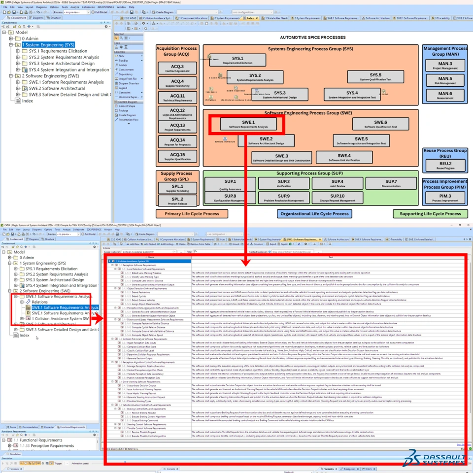

SWE.1 — Software Requirements Analysis: Software Requirements derived from SYS.2 via sysml:DeriveReqt. 55+ SW-level requirements (Lane Detection, Object Detection, Perception Data Aggregation, Collision Risk Analysis, Perception Algorithm Control, Driver Warning, Vehicle Actuation Control). Parent changes propagate automatically — no manual sync.

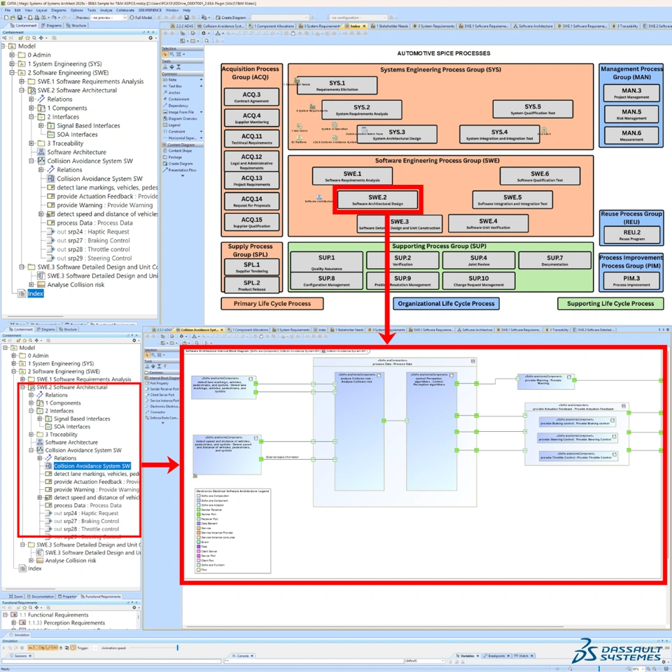

SWE.2 — Software Architectural Design: Software block diagram using SoftwareArchitecture:SoftwareComposition and SoftwareAtomicComponent stereotypes, with SenderReceiverPort interfaces and behavioral state machines. Key capability here: EE&S software architecture is AUTOSAR compliant. The model exports a native ARXML file from SWE.2, which can be imported directly into any AUTOSAR-compliant tool — Vector DaVinci Developer, EB tresos, Mentor Volcano, or equivalents — for ECU configuration, OS integration, and code generation. The architecture isn't just modeled, it feeds your production toolchain.
