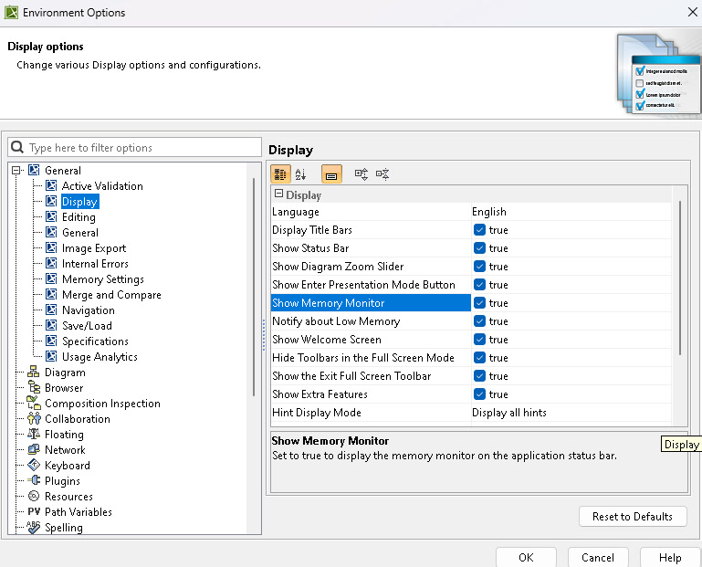

Where to change memory settings
First, the memory can be set during installation. But can also be set in the Environment dialog.
Other Settings
There are also a couple of helpful settings to get low memory warnings and see the memory monitor:
- Show Memory Monitor - shows the current, high-water mark, and max heap. Also has menu for memory debugging and force for garbage collection.
- Notify about Low Memory - On by default, this pops up a dialog when heap is almost full.

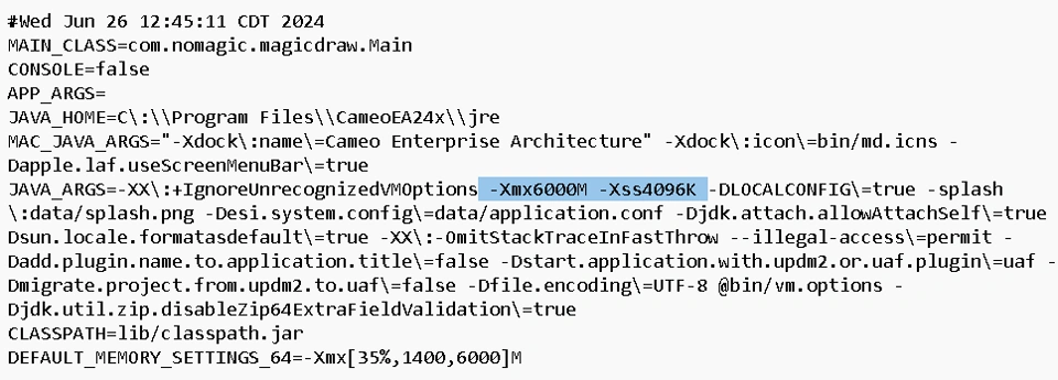

Memory Settings in the Properties File
If your tool fails to launch due to memory, it is possible to change the startup properties in the

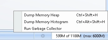

- The current used memory bounces up and down for various tasks, but you can force a garbage collection to reclaim any free memory to see what is currently being used at the time you press the garbage collection (note that memory monitor is enabled and right-cl
ick in the memory monitor to get the Run Garbage Collector). The following shows the right-click menu available in the memory monitor:
- The memory monitor shows three numbers: current memory in use, high-water mark (peak memory allocated), and max available. My installation's minimum high-water mark is 1100 MB to 1600 MB, depending on the config and plugins loaded.

Given this behavior, conservatively I’d recommend a max heap as low as 3000mb and as high as 6000mb (6000mb is what I have mine set to because I end up with very large models from customers). Enter 3000 in the max heap in environment options or in the properties file.
-Xmx3000M This should be a pretty good number for most users. However, when creating complex simulations, advanced queries or opening many projects, you may need to go higher. Use the memory monitor which also warns when you are running low on memory.
