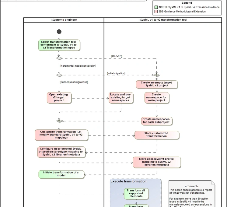

I would like to ask a question about the recommended SysML v1 to v2 migration process by DS.
In the "Customize transformation (i.e. modify standard SysML v1-to-v2 mapping)" step, I didn't really get how can i reach to the mapping within Cameo. As far as I know the Migration can be done by exporting a v1 model to v2 model, but this step doesn't include any customization option. Also in the SysML profile packages or SysML v2 Plugin documents i couldn't see anything specified for mapping. I would be happy if you can guide me about that.
