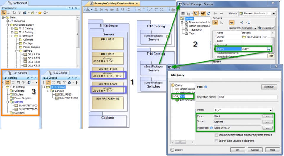

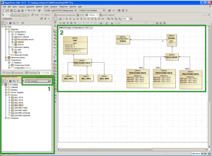

Figure 2 Constructing a system configuration from catalogs of approved baseline components
The process of constructing a baseline from a set of catalogs is shown in Figure 2. In this case, a variant configuration from the TI10/APB09 baseline is being constructed for a specific class of submarines. The TI10 hardware catalog is open in the browser on the left side of the screen capture (1), and specific servers are being configured into processing racks that will be installed on the submarines (2).

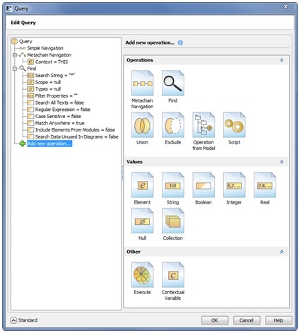

Smart packages are query based. The newly enhanced query engine (Figure 4) is extremely flexible and is now the most powerful in the modeling tools industry. The criterion can be as simple as a UML relationship and as complex as an Object Constraint Language (OCL) expression. You can define the following flavors of criteria: Simple criteria, OCL expressions, Meta chains for navigation through chains of properties, and Java code.
The criterion can also be any combination of the items from the preceding list. In addition, the Query engine is parameters based so one query result can be the parameter of another query, scope, or type, without any limits.

Figure 5 shows construction of the TI14 catalog of approved components from TI Hardware library of available components: (1) Smart package – the catalog Cabinet, Server, etc., use the query engine to aggregate required components dynamically. (2) Once the query is specified, the smart package –TI14 catalog content is created and updated automatically. (3) Some components, such as DELL R710, are imported into catalog TI14 manually by drag and drop. (4) Ownership of individual components, such as the DELL R710, is not changed and allows reuse in multiple catalogs.
Figure 5 Constructing catalogs of approved components from libraries of available components
Alternative solution is to construct catalogs based not on the import relations, but on properties values (1) Figure 6. Find query (1) is used to search for catalog TI14 components and show them in TI14 Smart package (3).
