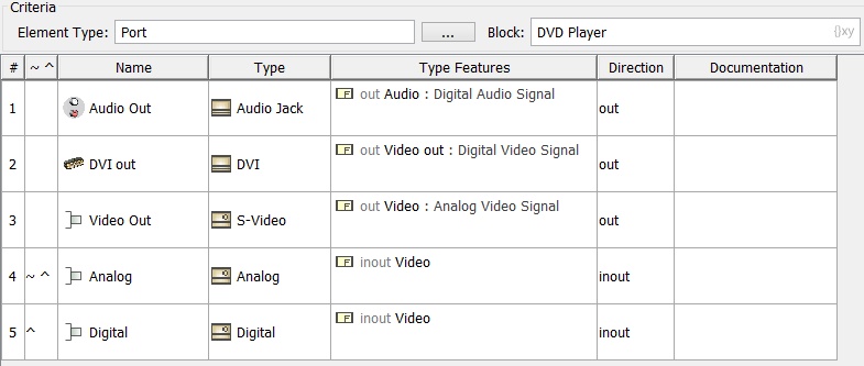

Blackbox ICD Table
A Blackbox ICD Table represents all external Ports and interfaces of the System (Block).

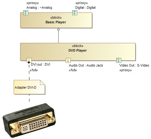

Case 1st Audio system
Fig 1. DVD player system
Fig 2. Single system ICD

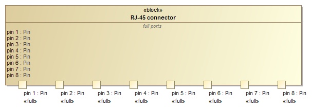

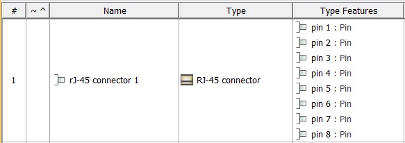

Case 2nd Network cable
Fig 3. RJ-45 connector system
Fig 4. Single system ICD

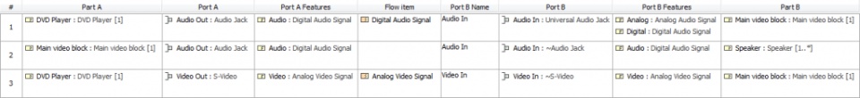

Whitebox ICD Table

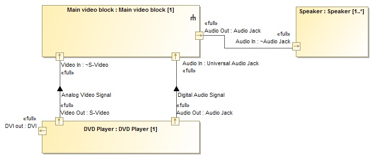

A Whitebox ICD Table represents system assembly – how Parts are connected via Ports. Case 1st Audio system
Fig 5. Audio system
Fig 6. Subsystems ICD Table

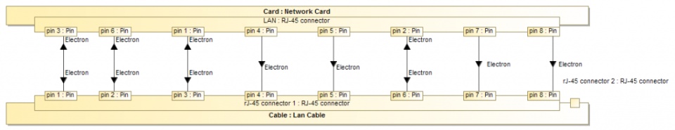

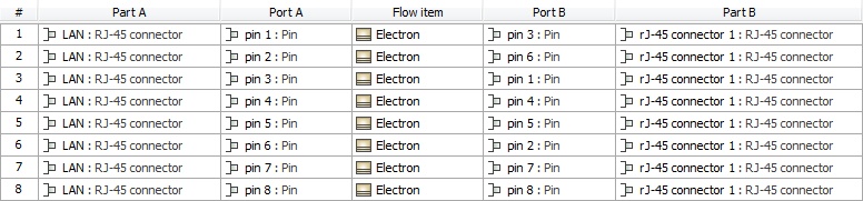

Fig 7. Network cable system
Fig 8. Subsystems ICD Table
