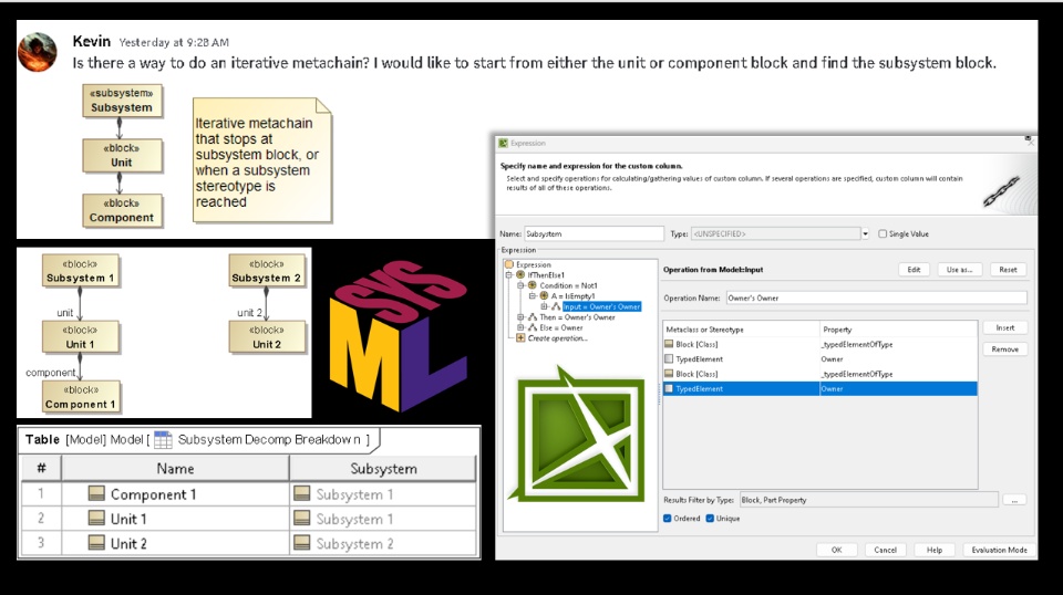

Iterative Metachains
In this video we discuss a community question about iterative metachains form the Systems Engineering Professionals Discord (https://discord.gg/XcNZSXuy). The question (linked here) is how to create a metachain that can return a value depending on its hierarchy whether its one level deep or multiple levels deep.
https://youtu.be/FGlaWee2_nI
Also see sample model attached.
