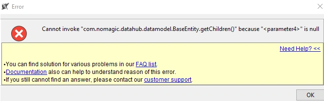

Getting UTF-8 start byte 0x0 error with 2024r1 and data hub.
I've checked the java args...and it does have the UTF-8 encoding set.
JAVA_ARGS=-XX\\:+IgnoreUnrecognizedVMOptions -Xmx4000M -Xss1024K -DLOCALCONFIG\\=true -splash\\:data/splash.png -Desi.system.config\\=data/application.conf -Djdk.attach.allowAttachSelf\\=true -Dsun.locale.formatasdefault\\=true -XX\\:-OmitStackTraceInFastThrow --illegal-access\\=permit -Dfile.encoding\\=UTF-8 @bin/vm.options -Djdk.util.zip.disableZip64ExtraFieldValidation\\=true
This is a problem with datahub going from Cameo to Jama.  Going from Jama to Cameo works better, but not all requirements are coming over.
I tried to trick the system by moving one package over to a Jama folder and that worked for the folder.  Then I tried to sync and only some of the requirements were brought over to Jama from Cameo.
also seeing this...
