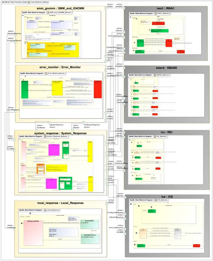

An idea of the overall complexity of the SMAP model is provided in the following figure. The SMAP Fault Protection Engine consists of an Error Monitor Statechart and Response Statecharts. External signals from device Statecharts, such as a reaction wheel, and the mode manager Statechart are input to the Fault Protection Engine.
The size of the model checking state space is a valuable indicator for the complexity of the model. Model checkers are computation and memory intensive. After initial model checking runs were found to take days to exhaustively check a small subset of the SMAP Fault Protection system, it became apparent that model patterns should aim at decreasing the state space. In an attempt to reduce the state space, adjustments were made to the model architecture and the Statechart representation of the fault protection system’s response tiers and response queue.

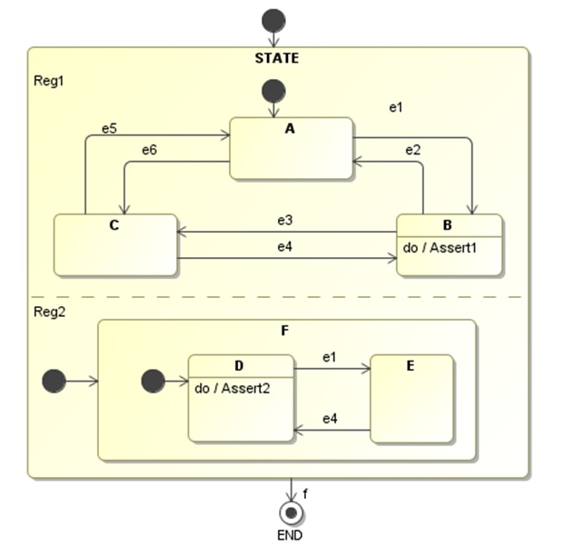

The Statechart in Figure 2 with orthogonal regions provides a straightforward example of a model checking application. The correctness property inserted is to ensure that state B and state E are never active at the same time: assert (inState(B) && !inState(D)).

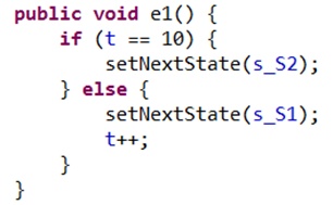

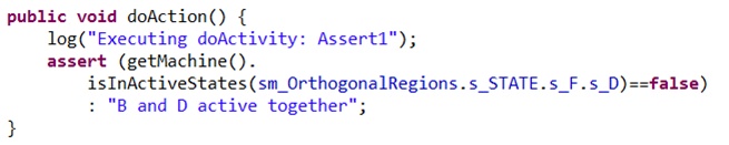

This Statechart is translated to Java using COMODO and the correctness property has been inserted manually into the code as shown in.
Figure 3: Inserting the Correctness Property.

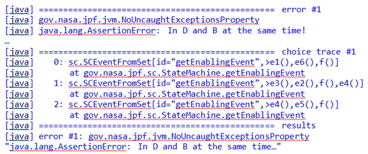

When JPF was run, it instantly found a counterexample to the assertion and output the error trace and performance statistics shown in the following figure. Following trace #1, error #1 was found because trace #1 defines an existing path that leads to B and E being active together. The statistics show that there is no elapsed time needed to perform this very basic model-checking task.
