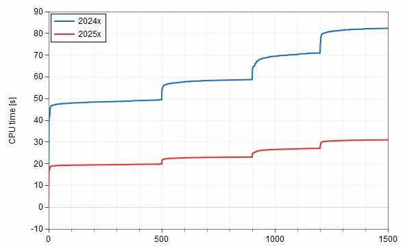

Simulation speed
Code generation for Modelica functions has been significantly improved, especially for array handing and with optimizations for constants and parameters. Typically, this has good effect in fluid systems with many function calls for media calculations.
For example, the VaporCycle model from the ThermofluidStreams library runs more than 2x faster.

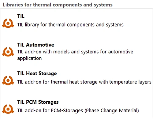

TIL-Suite libraries
The existing ThermalSystems library is replaced by TIL-Suite from TLK-Thermo. This change will offer more complete range of libraries and extended functionality. It is divided into four library products at Dassault Systèmes:
  • TIL Base Library
  • TIL Mobile Air Conditioning Library
  • TIL Hydrogen Library
  • TIL Thermal Storages Library
There is a free upgrade for existing customers of ThermalSystems to TIL Mobile Air Conditioning Library. Please contact your sales channel.
