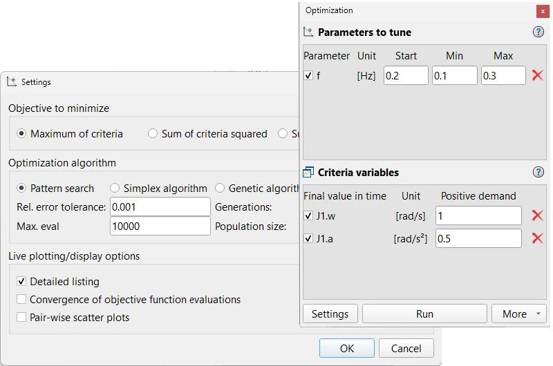

Parameter optimization
A new user interface for parameter optimization is available in Dymola 2025x Refresh 1. It uses simple drag-and-drop to set up tuner parameters, criteria variables and the optimization algorithm.
Up to three parameters can be optimized with the standard Dymola license, more require the Optimization option (DOZ-x).

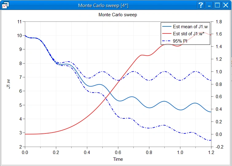

Monte Carlo simulation
Monte Carlo simulation in Dymola has been enhanced to allow analysis of the entire simulation trajectory, plotting mean value, standard deviation and the prediction interval.
We have also implemented box plots of the observed variable and general sensitivity analysis with Sobol Indices. In addition, an improved random number generator with Latin Hypercube sampling is used by default.
