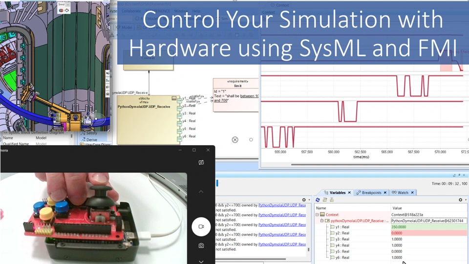

Control Your Simulation with Hardware using SysML and FMI
Excited to share an efficient and flexible solution for fast hardware integration with SysML and diverse simulation tools, leveraging the power of the open-standard Functional Mock-up Interface (FMI). It took some effort to find the right approach (big thanks @CS), but now we have a streamlined, out-of-the-box method!
Step-by-step video demonstrates how easily you can establish rapid communication between hardware—such as an Arduino Uno joystick—and SysML, along with other powerful simulation tools like CATIA CAD (Virtual Robot Simulation app) and multiphysics simulations in Dymola. FMI's widespread support across 200+ tools ensures flexibility and ease of integration.

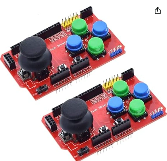

Used hardware example
Joystic scheald:
https://a.co/d/8m5Edsc

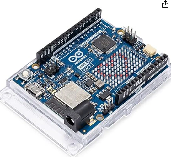

Together with Arduino Uno e.g. r4 wifi
https://a.co/d/cjkXax3

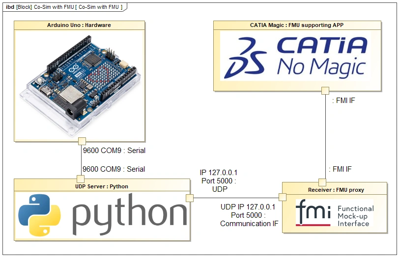

Integration details
Open communication architecture

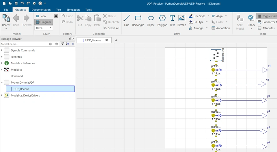

Dymola FMU configuration and export

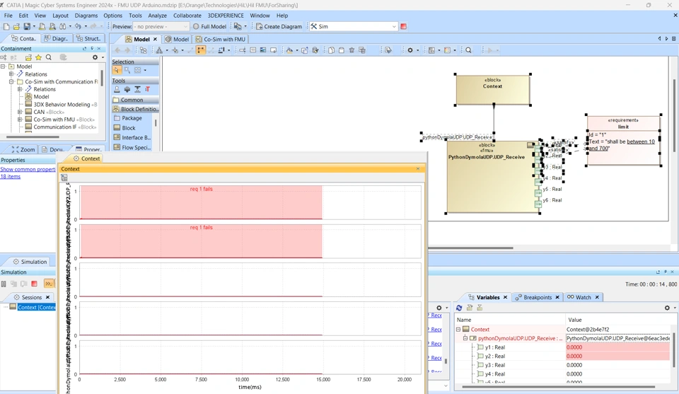

Catia Magic project with imported FMU for simulation:

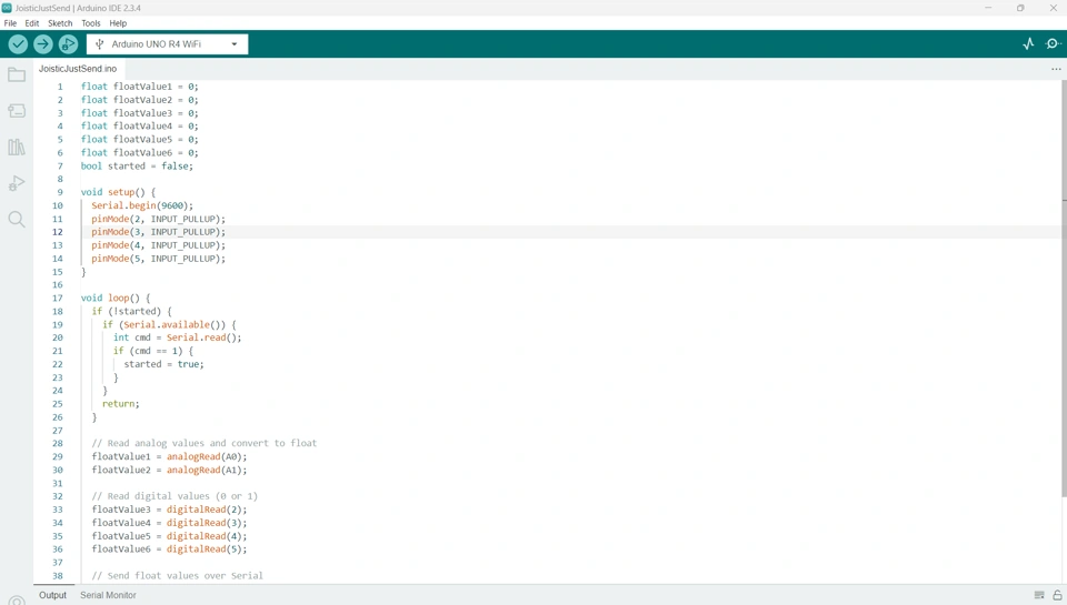

Arduino code:
Python script and execution to listen for Arduino serial port and send to UDP FMU in Catia Magic.
