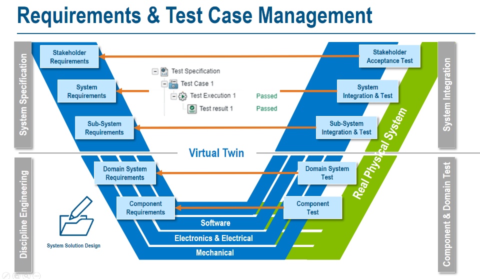

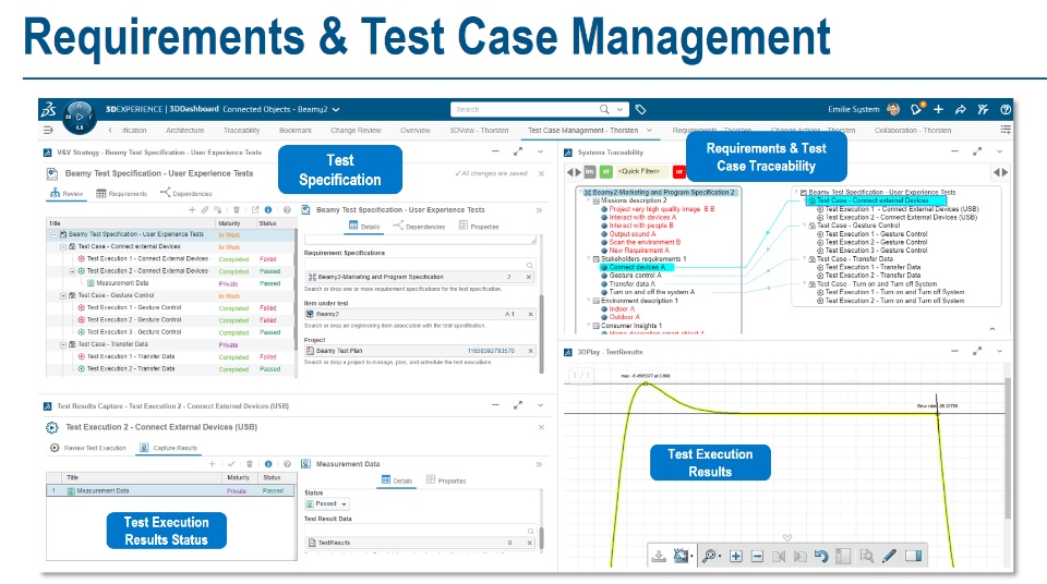

If we use for instance the V-diagram as a possible reference structure to represent the different levels of abstractions and domains in our engineering process (engineering processes are usually not really a V as they have a lot of iterations and are never purely sequential, but the representation is useful to illustrate the different levels of abstractions), what we want to achieve here is a digital continuity where we connect requirements specifications on the left with the test cases on the right in a fully traceable manner (including their revisions). And it does not matter whether the test result was gained through a simulation or physical test rig, we want to consume and connect both data. In order to do so, 3DEXPERIENCE provides a test management role (VRP) that provides a data model based definition of the test and allows to link these test cases to corresponding requirements. To overview the traceability between larger requirements and test specifications the traceability role (TRG) can be used to manage the overall traceability & navigation. All of this can be compiled into well organized dashboard in 3DEXPERIENCE as illustrated below where you see on the left a test specification with test cases and test executions defined.

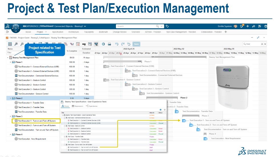

On the right it illustrates in real-time the traceability relationships between requirements and test cases. The test specifications can also be equipped with additional data, e.g. which item we are testing against (in this case a physical product) as well as a project to which we want to link this test specification. If you specify a project then the test executions will show up as "tasks" in this 3DEXPERIENCE project. That means this test specification can either be a standalone project itself or it can be part of an overarching project plan for the product that is to be developed. This is very useful and will allow us to also define the schedule for the test executions so that we have a clear overview when each test will be executed. This allows us to also plan the needed & available resources, all aggregated and represented in a nice Gant Chart.

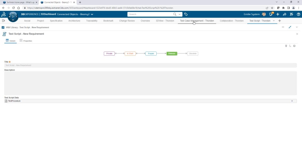

I have attached a demo that I created for some customers showing the complete process from defining the test specification, test case, test execution and connecting it with requirements, leveraging an end-to-end traceability to identify and add the physical test product as well as embedding all of this into a project management approach. Finally this is turned into an Excel spreadsheet report for exchange purposes with 3rd party tools or documentation.
