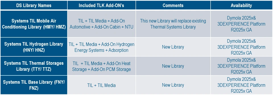

We are pleased to inform you that from Dymola 2025x release and 3DEXPERIENCE Platform R2025x GA release TIL suite libraries will be available in Dassault Systems Library portfolio.
Packaging
Existing Thermal Systems Library will be moved to Controlled Availability [CA]. This library will be replaced by Systems TIL Mobile Air Conditioning Library. This new library is equipped with conversion script. All existing Thermal Systems Library models will be converted to TIL Mobile Air Conditioning library by following few steps -
