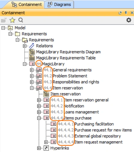

Dassault defines requirement numbering here (for example):
Note that the requirement number, is also its ID.
Next, note that the Number dictates its location in the structure tree:
  1. So what happens when you MOVE a requirement? Answer: The Number changes, Answer: The ID changes.
  2. So what happens when you add a requirement above an existing requirement? Answer: That depends on if you allow it. Generally speaking, you cant (Generally speaking, the new requirement gets the next available number, and in turn, is at the bottom of the structure tree for the parent containment you added it - thus, there is no semblance of structure or order, or organization unless you renumber everything, which is quite a complicated and fussy operation; it's also something you should never be doing???).
