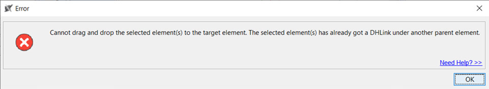

One more interesting question. If you have even begun a sync (of a single DOORS module) and then cancel it, or, decide to delete the objects on the Cameo side, (and even choose to tell Cameo to remove all DHLinks), you are still unable to then later do a "Copy Data With Sync" ever again because it throws this error:
We should not have to remove the DataSource, especially if contents in it are already being used elsewhere - how do we get Cameo/Datahub to acknowledge that there are zero items from the DOORS module in question existing in the Cameo model, and thus, the error above should be incorrect and it should allow the new copy/sync operation?
