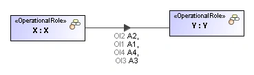

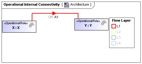

For example, here are two performers exchanging four messages. Imagine dozens of nodes and hundreds of messages. What if I want to make a view for a specific stakeholder that only shows message A1?
With this design, there are few choices when looking at the IBD (a connectivity diagram in UAF) as modeled as a connector with multiple exchanges. We could manipulate the realization to show what we want to see. It is easy for the given example but difficult for a complex diagram with many messages/nodes. Also, exchange realization is not a visualization (a diagram option) but has semantic meaning (it is part of the model data). Because of these facts, the tool fights you to maintain one realization in the context where the IBD (connectivity diagram) structure resides.

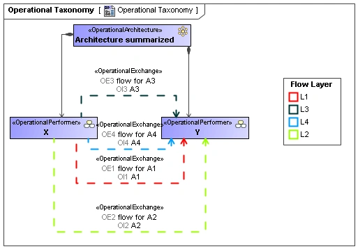

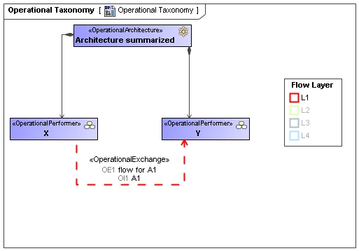

Since the exchange is also part of the model, a structure or taxonomy diagram (a BDD in SysML) can show it. We can use the Legend for each set of messages for specific stakeholders. Note that when you create dynamic legends, you can use the package structure, stereotypes, or other information to automatically apply legends to specific stakeholders and avoid a lot of manual labor to annotate the diagram.
https://docs.nomagic.com/display/MD2024x/Creating+Legends
All Exchanges
Filtered

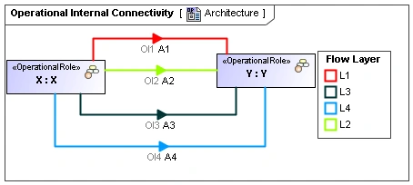

A related cure is to refactor your model. Create separate connections per stakeholder. This allows you to use the Legend again to hide/show a specific configuration. Using the legend filter capability, we can show the stakeholder-specific configuration. Related to this
All Elements
filtered

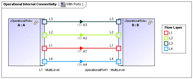

Another method is to use ports and sub-ports. The above, we use another feature that summarizes the connections. Using templates, you could use variations of ports and/or supports to lay out the structure for a specific stakeholder.
UAFExchange

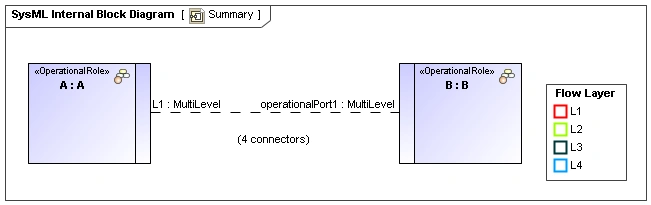

In addition, there is Semantic Zoom. To use it in UAF connectivity diagrams, refactor the connectivity diagram type to SysML IBD (it can probably used in UAF directly by customizing the diagram, but this is an easy workaround to see Semantic Zoom on the smart manipulator). The result is a diagram with the paths but not the specifics. This lets you see the network without the clutter of multiple connectors.
https://docs.nomagic.com/display/SYSMLP190/Displaying+actual+Connectors+and+ports
