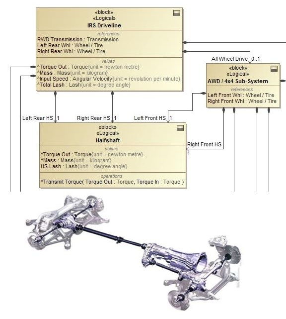

This paper documents the real-world application of model-based systems engineering (MBSE) methodology and principles to an automotive driveline system. A system model developed in the course of this thesis supports the definition and sizing of the driveline system to best communicate and deliver functional specifications tied to customer requirements. Furthermore, this system model documents, organizes, manages and provides traceability for all customer, system, sub-system and component level requirements and is a useful tool supporting the system architecting and specification cascade process.
Team investigated and analyzed existing driveline component sizing tools and developed an exhaustive list of key assumptions and system design requirements which have been linked through a comprehensive SysML model. The key project deliverables are the SysML system model and a list of lessons learned / best practices collected during the development process.

Major benefits of applied MBSE
  • A significant tool for automotive system design that offers many benefits, especially in communication through a common language
  • Requirement traceability is vastly improved
  • Faster delivery time along with more robust results and less cost
