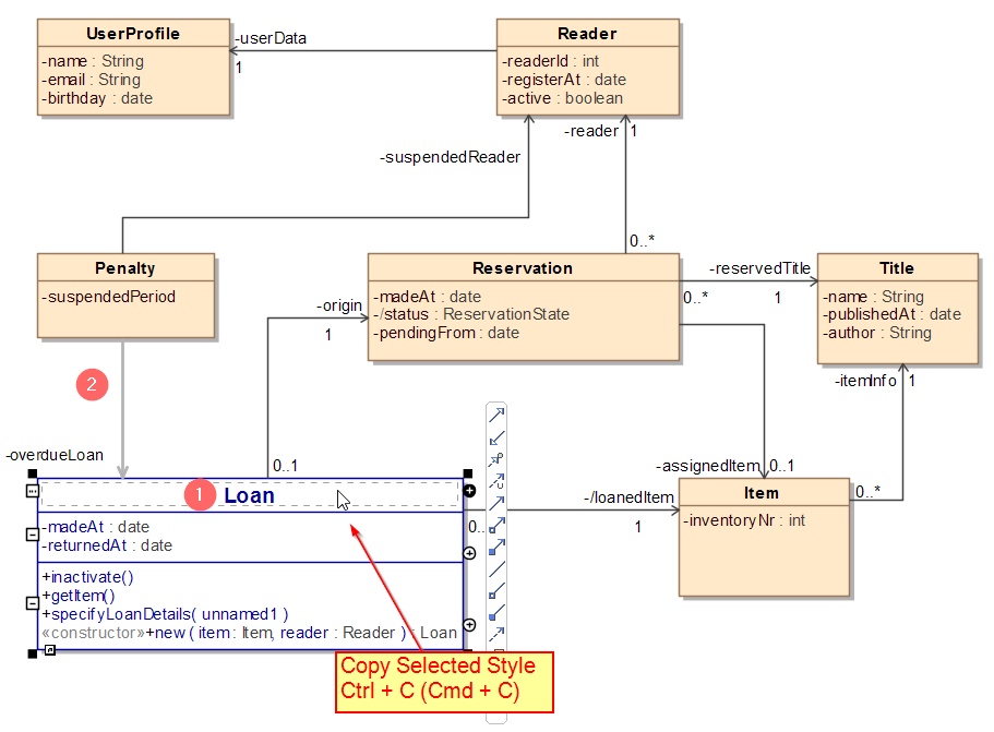

In Figure 1 I have desired style for the class: blue color for text, displayed attributes and operations compartments, bigger font size for name and white color with blue borders. All these you can set in Symbol Properties dialog.
After symbol is selected you should copy style using shortcut Ctrl + C (Cmd + C for Mac users).
Copy Style – Ctrl + C
Paste Style – Ctrl + Shift + V
There are two bubbles in Figure 1 showing that you can set one style for the class (1) and another style for the relationships (2). So, in the next steps we will apply two styles for both sets of symbols – classes and relationships.
Figure 1. Copy style of the selected symbol
After the style is copied we need to select symbols to which this style should be applied.
TIP: you can hold Shift key to select a couple of symbols or Alt key to select all the same type elements (all classes or all associations).

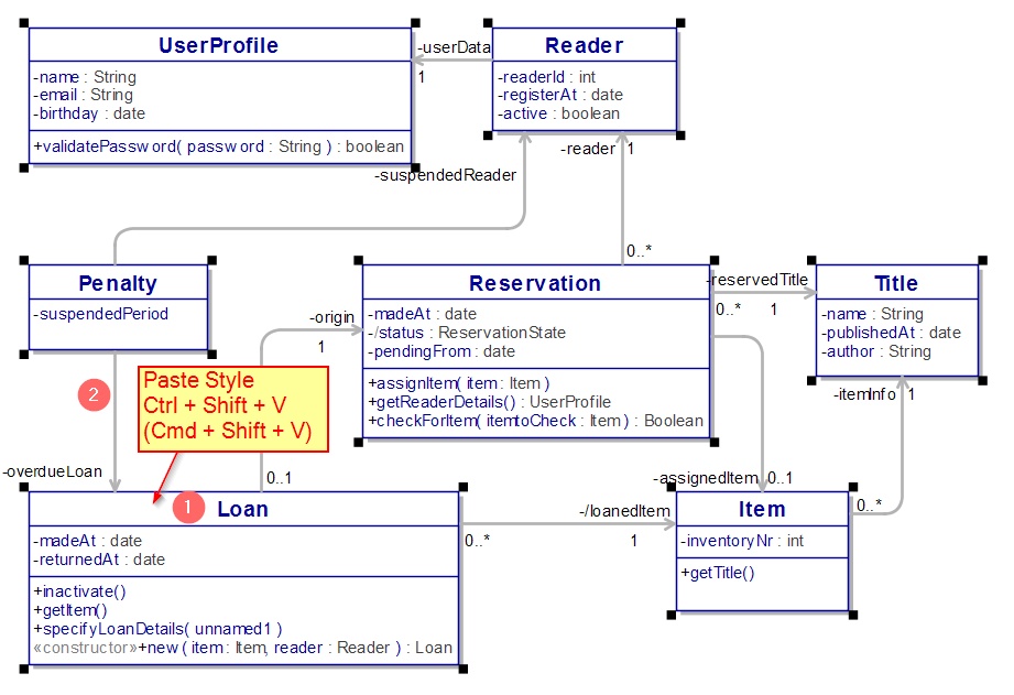

When symbols are selected, the last step is to apply the style using the shortcut Ctrl + Shift + V (Cmd + Shift + V for Mac users). See the results in Figure 2: style is applied for classes and relationships.
Figure 2. Paste style for the selected symbols

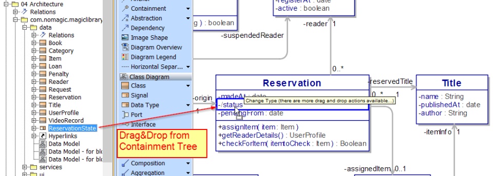

Most of the drag and drop functionality is used this way: drag the element from the model browser (containment tree) and drop into the diagram (on empty space in the diagram area, shape, line or inside the shape). When you drag the element on the diagram empty area it will create a symbol depending on the diagram type. If you drag the element on diagram symbols like shape or line, it should be highlighted with blue color and a tooltip displayed showing what will happen after dropping the element.
Check the example in Figure 3, where the Enumeration element ReservationStatus is dragged and dropped on the attribute and MagicDraw automatically assigns the type for it.

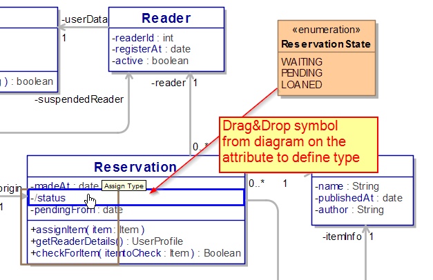

There is also possibility to drag and drop symbols directly from the diagram as shown in Figure 4.
Figure 3. Drag & drop Enumeration on the attribute to define type
Figure 4. Drag and drop Enumeration from the diagram on the attribute to define type

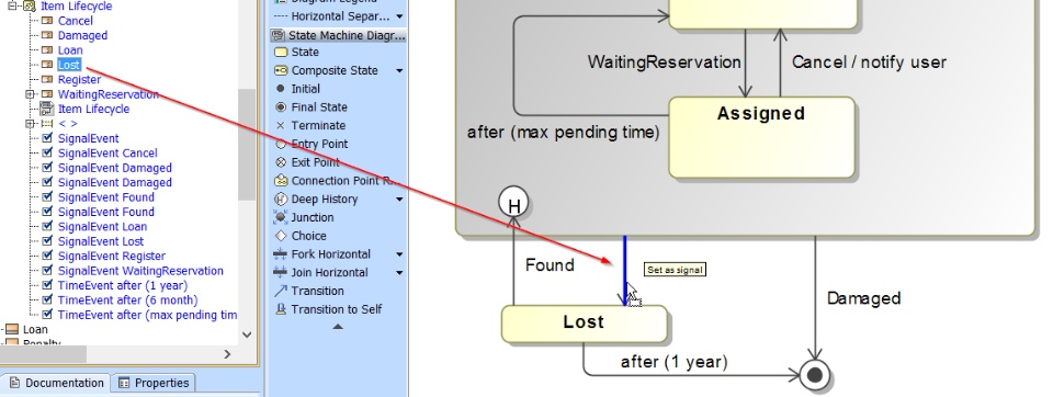

For example, if you drag and drop signal element to the class diagram, MagicDraw will create symbol similar to the class. Dropping the same signal on the transition in a state machine diagram  will create a trigger with defined properties as a SignalEvent event type and specified signal (see in Figure 5).
Figure 5. Drag and drop signal on the transition to create SignalEvent and assign signal

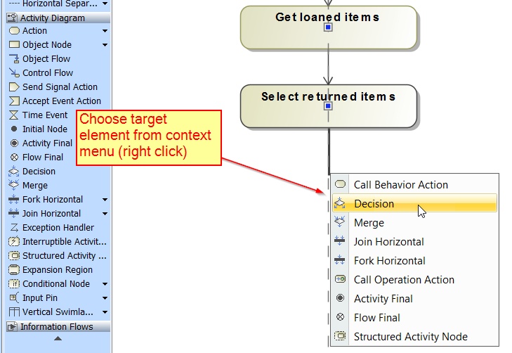

When you select an element in the diagram, the smart manipulator should appear with most expected relationships and sometimes additional functionality (see in Figure 6). After selecting the specific relationship, you can choose possible target elements from the context menu which you can activate with the right mouse click (see in Figure 7).
Figure 6. Select symbol in the diagram and choose relationship from smart manipulator
Figure 7. After clicking context menu (right click) choose target element

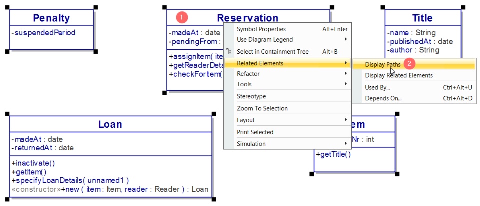

Display paths
The other option to create a diagram quickly is by dragging and dropping elements to the diagram and displaying the relationships which exist between them. You need to select all elements in the diagram (see in Figure 11 part (1)) and then from right mouse click context menu choose to Display Paths (2). All relations which exist between selected elements will be displayed in the diagram.
Figure 11. Context menu for Display Paths
