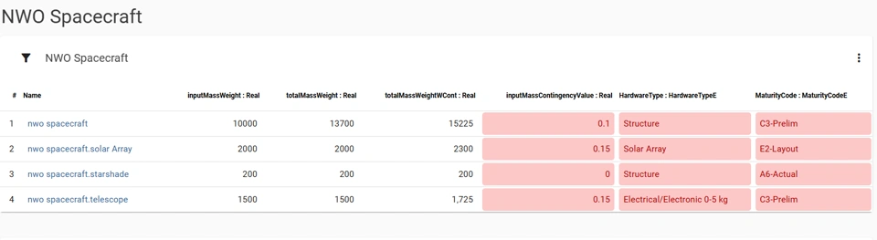

Hello,
I was able to create a server side simulation using an instance table. There is one part of the simulation that is not working. I have a script that executes as part of a rollup pattern that performs a simple table lookup that fails.The rollup pattern uses a constraint block that has a Groovy script that performs the lookup. The simulation works just fine when executed within Cameo.
Here is an excerpt of the script:

The table is defined in the script.
