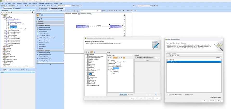

2026x HF2 Unable to Apply ForceDesignation to Operational Performer
mission engineering UAF When I attempt to create a value for the OpposableElement tag I am not able to get a pull-down. Instead I just get a link to the enumeration.
The tag definition in the stereotype uses the type DesignationKind for the tag, not ForceDesignation.  DesignationKind is the base stereotype for ForceDesignation. This appears to be an issue in the UAF v1.3 profile.
