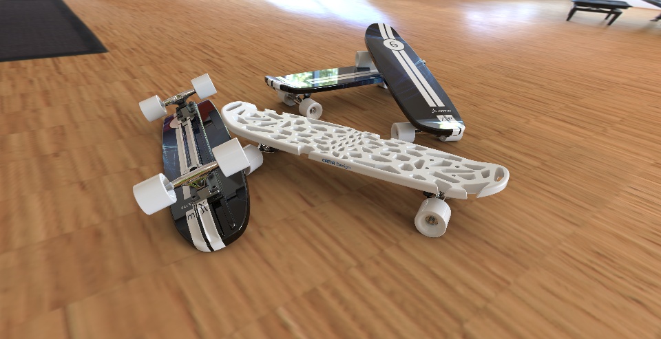

Skateborganic is an innovative skateboard concept that I’m doing by using Dassault Systèmes technologies. The driver for this project is to make a strong skateboard, light, and aesthetically surprising/appealing, that could be achieved exclusively with 3D printing technologies.
Given that the current trend is little plastic skateboards, from Globe or Penny brands, I wanted to take the opposing view, by creating a plastic skateboard with more conventional (and practical) dimensions.

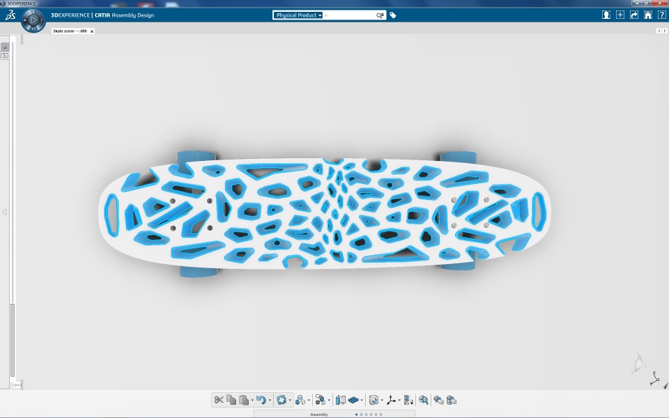

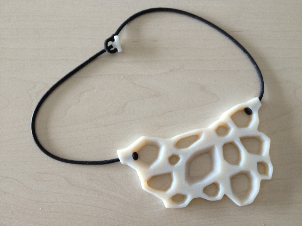

- First, I wanted to make a pure styling study inspired by a Jewelry object made by an other member of the CATIA design team (Aude). This jewel was inspired by nature with some very organic shapes and I was curious to see what could give this design intent on my skate board.
- The second challenge was to create the multiple artworks on the skateboard and to be able to play with multiple colors ranges & variants.

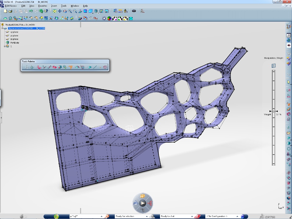

- The third goal was also to imagine a new design of the shape by using an innovative technology of "Shape topology optimization" from physical simulation (to have a good balance between weight & strength). But this is an other story that I am just starting to work on.
- And at the end, once shapes will be computed by the software (Abaqus, using ATOM solver), I will have to find a compromise between style and engineering, and it is probably the most exciting point in this project.

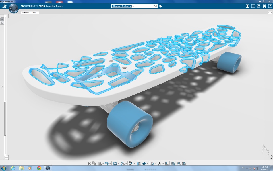

What are the specific Applications of CATIA Creative Design that you used to design the skateboard ?

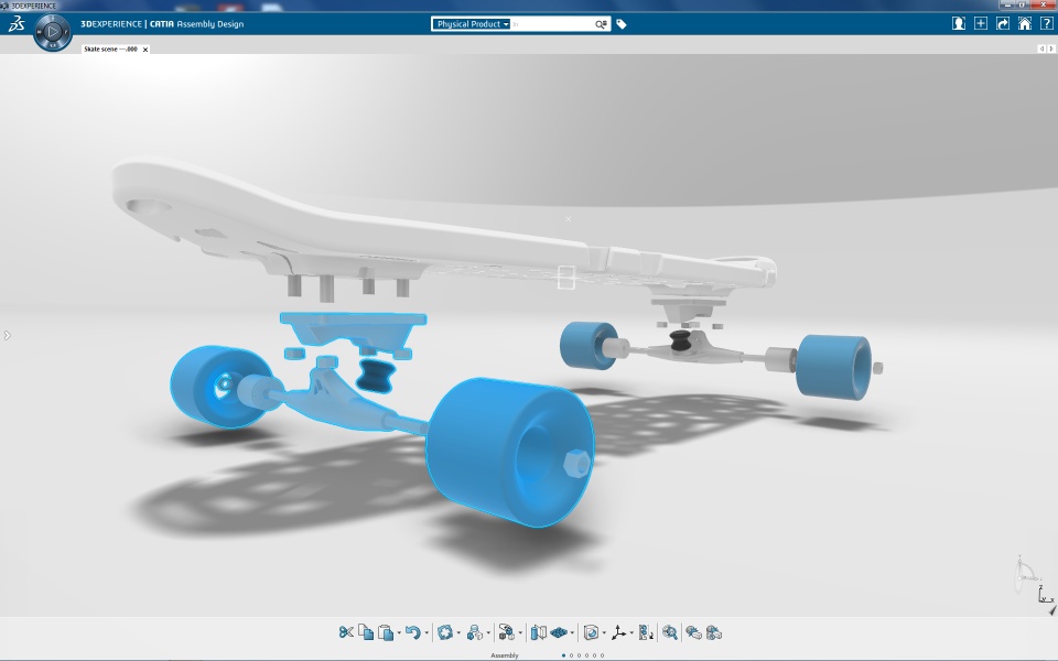

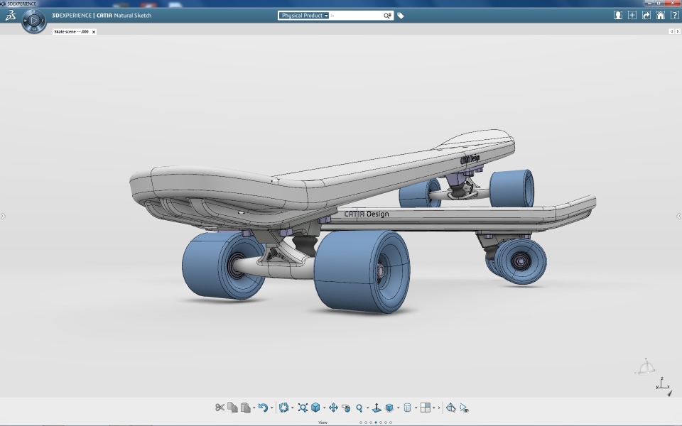

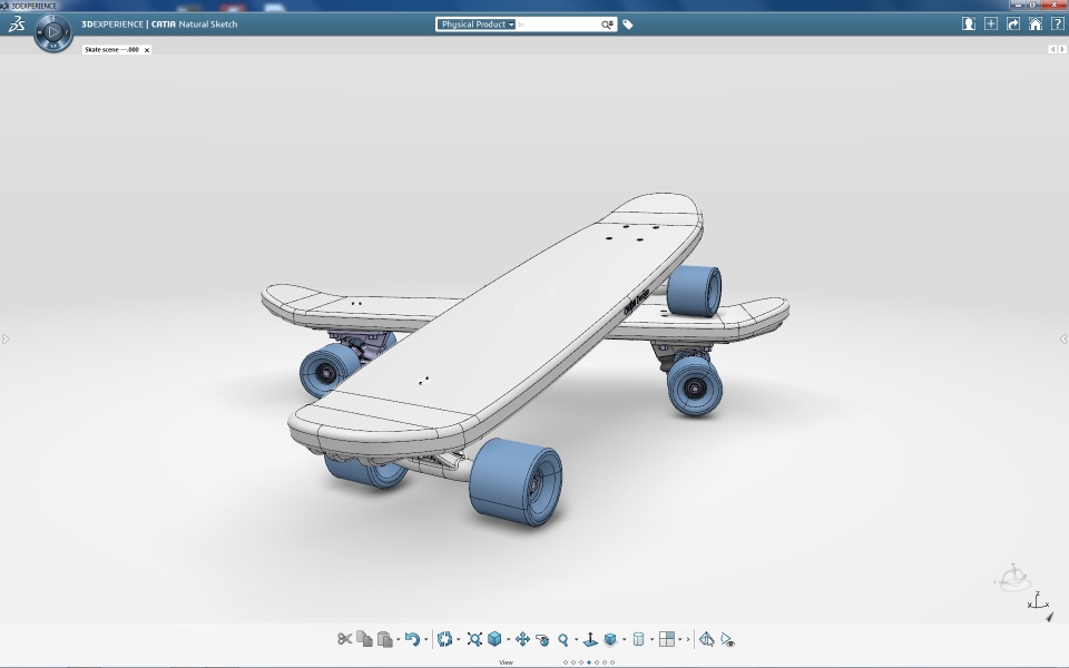

For the Shape Modeling:
As I said previously I wanted to create a basic Skate but also an organic Design inspired by nature. For That I used the different modeling capabilities of CATIA that allows to create very precise surfaces with a lot of Freedom & flexibilities. For That I used CATIA Part Design, Generative Shape Design and also CATIA Creative Design.

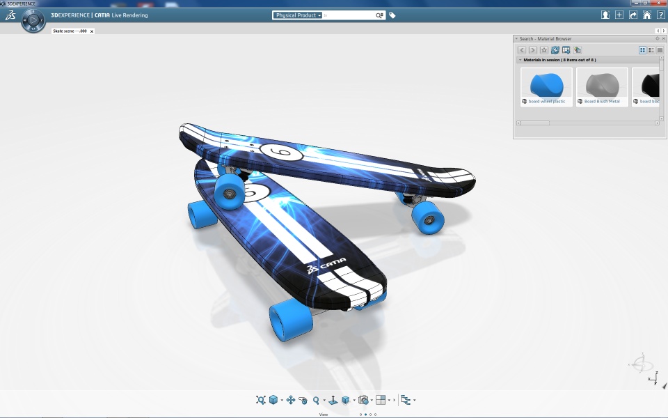

For the Visualization aspect:
Designing the shape was important for this project but I also wanted to work on the artwork on the board. The real-time visualization & rendering capabilities of CATIA Creative design helped me to position and see the different artworks that I wanted to put on the Skateboard.
I also used realistic visualization & Rendering to define the different color & materials, to define quickly the right combinations & harmonies. It also helped to compare some variants quickly.
I also used the high end rendering capabilities of CATIA Creative Design to produce realistic visuals to present my project, to put SKATEborganic in context is some real environments. With the 360° HDRI environement I could produce in few seconds realistic images of my skateboard in different envionement & lighting conditions.
