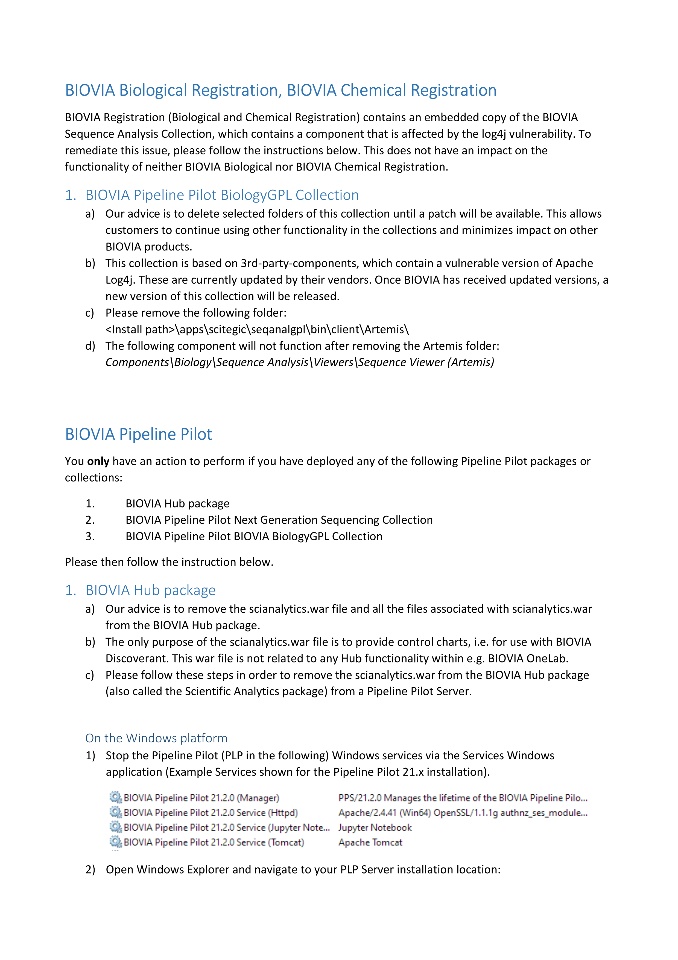

BIOVIA has now published the impact of the Apache Log4j vulnerability (CVE-2021-44228) and the proposed mitigation for BIOVIA software. The Knowledge Base article on our Dassault Support News site referred to earlier has now been updated. Please see the link to the most recent document under the "BIOVIA Pipeline Pilot" section:
https://kb.dsxclient.3ds.com/mashup-ui/page/document?q=docid:QA00000102301​​​​​​​
This also explicitly means, that apart from the Pipeline Pilot packages listed in the linked document, no other BIOVIA software is impacted by this vulnerability.
