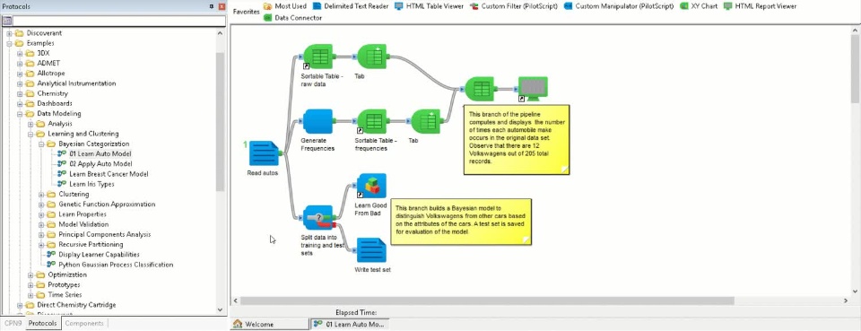

Did you know you can schedule jobs directly from the Pipeline Pilot Professional Client?
Right click on your saved protocol in the protocol's tab, select "Schedule protocol…" and choose when and how often you want your protocol to run.
