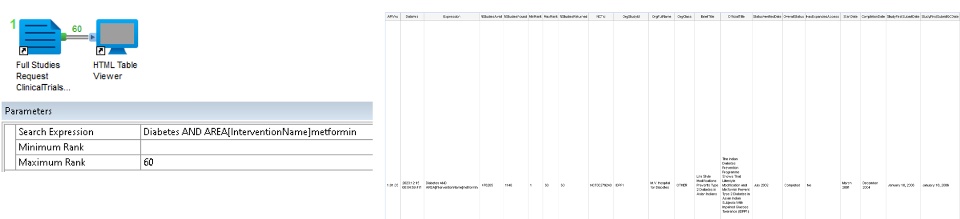

My dear colleague (and friend!) @VS and I made the following components to query the ClinicalTrial.gov API in order to fetch the clinical data into Pipeline Pilot. You can find below descriptions of the components, screenshots and associated example protocols.
Full studies requests:
This component queries https://classic.clinicaltrials.gov/api to receive back all content for a small selected set of study records.
Field values requests
This component queries https://classic.clinicaltrials.gov API to retrieve all values found in a single field of the API for a set of study records. If the Search Expression parameter is left blank, the API returns all field values found by the search by default. The full list of study fields can be found here: Study Field List
Study field requests
This component returns values from selected API fields for a large set of study records. The response to a Study Fields query URL provides information for selected publicly available fields for many studies fetched from https://classic.clinicaltrials.gov/api
