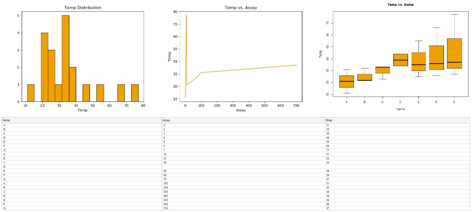

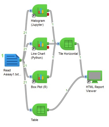

I wanted to share this little protocol I did with my friend (& colleague) @TH. It's a little reporting protocol generating 3 simple charts, BUT in 3 different ways! AND in simple but reusable components. What's not to like!
It's not about the chart here, it's about having a quick starting point, for you to learn how to reuse some snippets of R or Python code, and use them both in a single protocol.
The protocol looks like this:
The magic behind:
  1. Each script generates one chart
    • R Scripts generate an image
    • Python scripts generate a base64 string of an image & then PilotScript ConvertFromBase64() converts it into an image
  2. Image from Data component creates a Reporting element from the image
  3. Any Report Viewer will do :)
  4. Bathe in glory
They are also componentized, so you can learn how to add a few parameters to your component, so that your friends don't have to go in your R or Python code.

Script componentPython Jupyter Notebook (on Server)Python (on Server)R Custom Script
Before the component-Merge All Data-
Color parameter mapping
import ppdataloader
plp_df, plp_params, plp_globals = ppdataloader.loadPipelinePilotData()
color = plp_globals.get('Color')
import pilotpython
context= pilotpython.Context(ctxt)
props= context.getComponentParameters();
color= props.get("Color").getValue().getString()
\\\$(Color)
Output PortPass PortPass Port
Fail Port
PilotScript after the ComponentConvertFromBase64(Histogram)ConvertFromBase64(Plot)-
And yes it works, see the output:
I told you, it was not about the chart 😉
