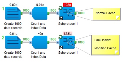

First you will need to configure the Local Temp Directory to point to a local folder. This can be done from the Admin Portal under Setup > Folder Locations. (Details and Instruction are at the bottom of this post)
In the example enclosed, I make use of the hidden parameter CacheCategory existing on the cache component. When this parameter is configured to point to \\\$(LocalJobTempDirectory) and the CacheID Scope is Cache Category, the cache component will make use of the implementation and the information will be stored locally on the execution server, saving the overhead time involved in the use of NFS.
Notice that as the cache is located on the executing host creating it and not accessible outside the node.
Execution example
Implementation
Example Protocol
The more noticeable impact is under Load Balance, on a comparison test I could see a 9-fold improvement when using this approach.
