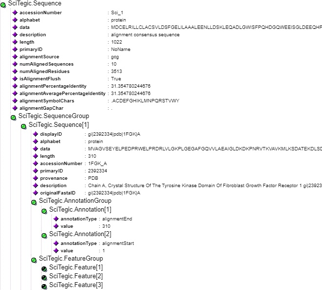

However, there are cases when the data is more complex than that, and a simple one-level flat data model is not sufficient to hold all the information in the input. In these cases, Pipeline Pilot uses a hierarchy, with a root node at the top with properties associated with it just like in the flat example described above, and additional child nodes attached to that root node in a multi-level data model. This representation is critical when working with more complex data, and Pipeline Pilot provides multiple ways in creating, manipulating and visualizing this data. An example of hierarchical data record is shown below (as above, green balls represent nodes, purple diamonds are properties):

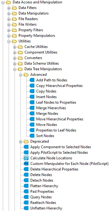

Components that are available for manipulating hierarchies are shown below:

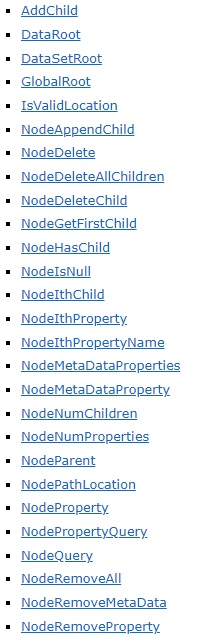

PilotScript functions for manipulation hierarchies:

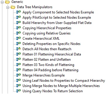

There are lots of example protocols that cover many different use cases under Protocols/Examples/Generic/Data Tree Manipulators:
