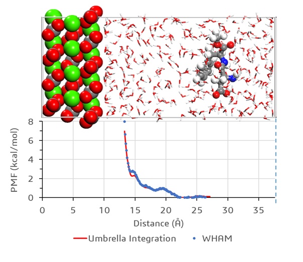

The PMF is calculated for the center of a molecule, between given begin- and end-points. The path is divided into a number of steps (or “windows”). For each window a molecular dynamics simulation is run, in which the molecular center is restrained to a fixed point (anchor) on the path. The restraint acts as an umbrella potential. The histogram of the distance from the anchor point, projected along the reaction coordinate is evaluated for each window.
On completion, the histograms can be analyzed in two ways: in WHAM the histograms are reweighted to construct a histogram that spans the entire reaction coordinate interval. The PMF then follows as the logarithm of the overall histogram. In the Umbrella Integration method, the mean force is evaluated using a Gaussian approximation to each histogram, and the PMF is obtained through integration of the mean force.
Example output is included for aspartame approaching the {1 0 4} face of calcite, in water. This run was performed without analysis; you can run an analysis by setting the analysis flag(s) to TRUE and setting the \\\$doc parameter to the location of the study table. Running the analysis creates additional columns and sheets in the study table, without repeating the umbrella sampling.
