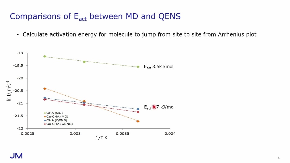

A Combined Quasi Elastic Neutron Scattering (QENS) and Molecular Dynamics (MD) Study of Diffusion of NH3 in Zeolites

Following on from this the accessibility of the active site is assessed using the diffusion of NH3 in the CHA framework as a test case. Molecular Dynamics (MD) simulations have been widely used to study the diffusion of molecules within zeolites. There are a number of complimentary experimental techniques, such as Pulse Field Gradient (PFG)-NMR and Quasi Elastic Neutron Scattering (QENS) that can probe the same length and time-scales as MD simulations and therefore provide a direct comparison. Using both QENS and MD simulations, we investigate the effect of the Cu2+ counter-ion on the diffusion of NH3 by comparing to the brønsted acid form of the zeolite.
