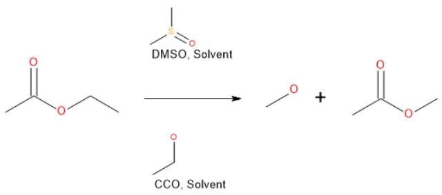

There is an example of this new feature in the BIOVIA Draw Help. Open the BIOVIA Draw Help and search for “adding reagents”. The Adding Reagents link above brings you to:
You will find instructions and see an example of a reagent, including a name and comment added to a reaction.
