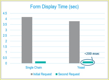

Registration forms load much faster due to the use of client-side metadata caching.

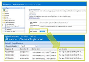

The Recent Activity grids on the Biological and Chemical Registration home pages can now show dates in your local time zone and format.

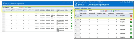

Completed preview jobs in Chemical Registration can be resumed from the View Recent Submissions page.
Manually stopped Chemical Registration jobs can be resumed from the View Recent Submissions Page.
Faster form loading: This chart shows the impact that client-side metadata caching has on the speed that forms render for all subsequent requests (the caches are populated the first time a form is requested). In testing we found that forms loaded up to 23x faster than before!
This change makes the web client much more responsive for all users!
Show dates in your time zone and format: Here we are using the Configure Data Format parameter available in the Pipeline Pilot Admin Portal to enforce our chosen date and time zone format on dates displayed for recently viewed records on the Chemical Registration home page. This works in Biological Registration too!
Resume jobs: This shows how the Stop and Resume controls available on the View Recent Submissions page in Chemical registration can be used to resume preview and manually stopped jobs without needing to set them up from the beginning or work out where a job stopped in order to restart it.
