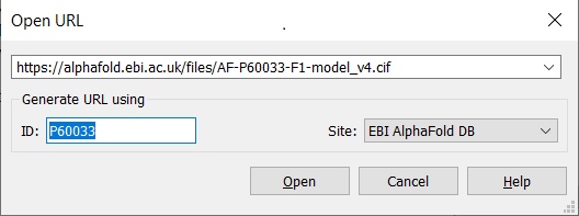

The AlphaFold structure of the protein can be loaded by opening File>Open URL, entering the UniProt ID and choosing EBI AlphaFold DB as the Site e.g.:
There is more information about this functionality, including changing the version number if needed, in the Discovery Studio help under Help>Help Topics.
